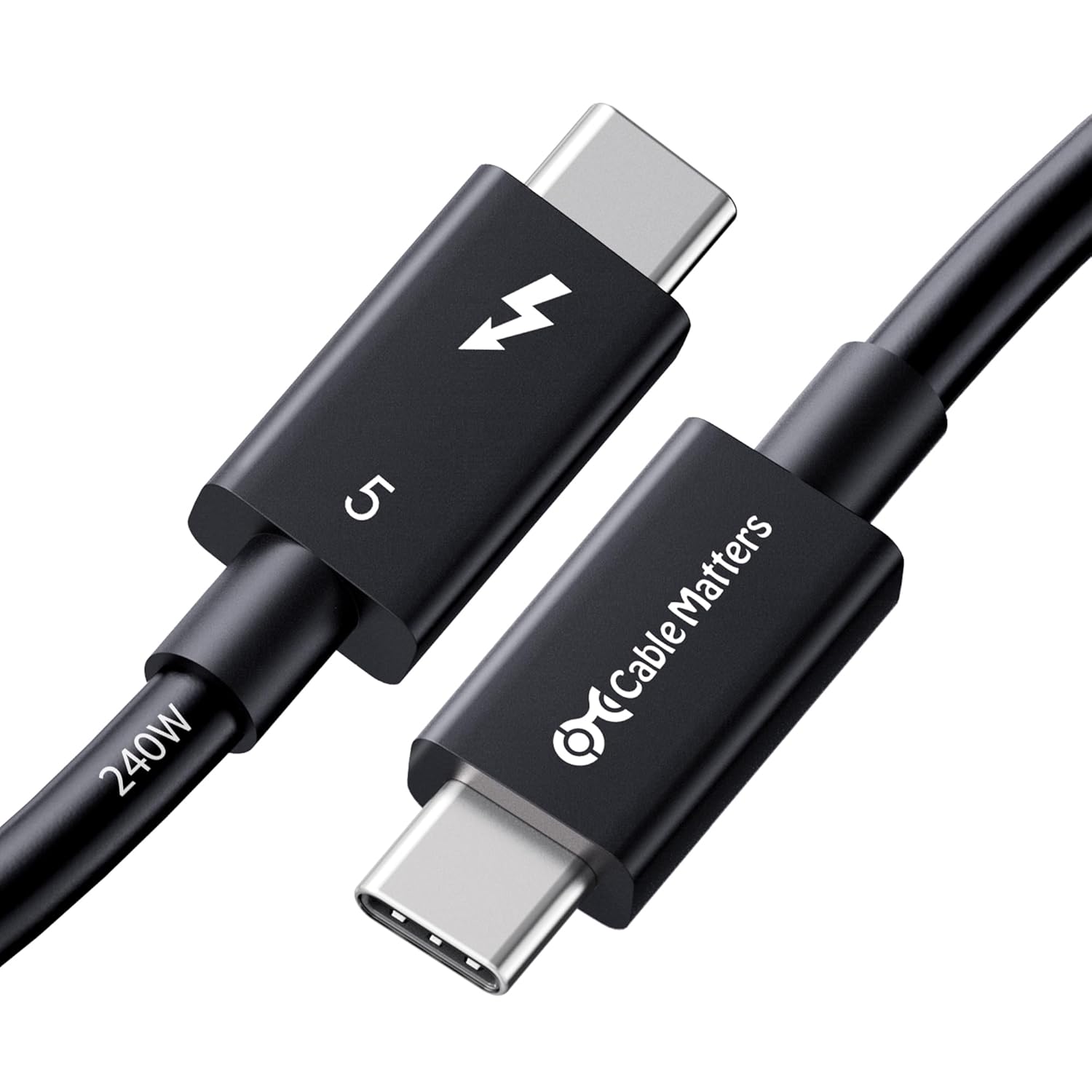

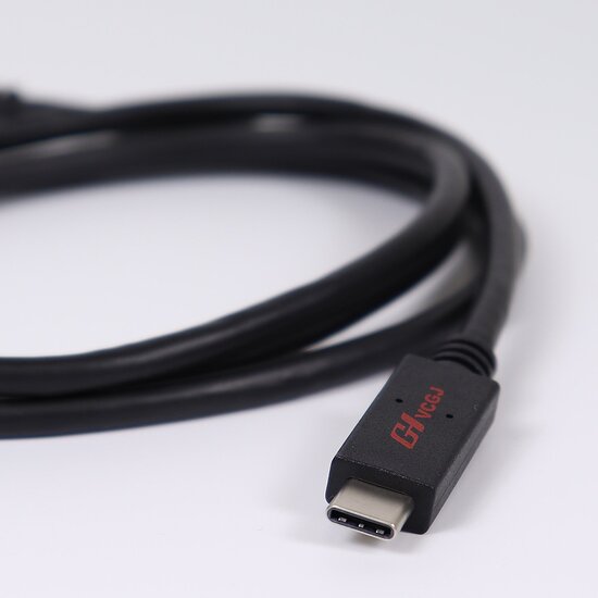

I’ve tried debugging everything I could think of / saw recommended here (aside from the ferrite clamps mentioned above). I switched from the L1T USBC to the CableMatters Thunderbolt; upgraded to the Fibbr DP cables (which fixed my issues on the Linux side); tested the Mac output on both monitors; tried switching USB-C ports on the Mac; installed BetterDisplay and tried various settings (e.g. changing the refresh rate doesn’t fix the issue, happens at 144Hz, 120Hz, 100Hz, and 60Hz). The KVM is set to the 4 Lane/USB-2 setting.

I initially tried with this L1T cable:
then switched to this (1m):
OP was saying they tried various cables (including the Club3D) and still had this issue, so I figured I’d ask before running through more cables. But anything’s worth a shot at this point
