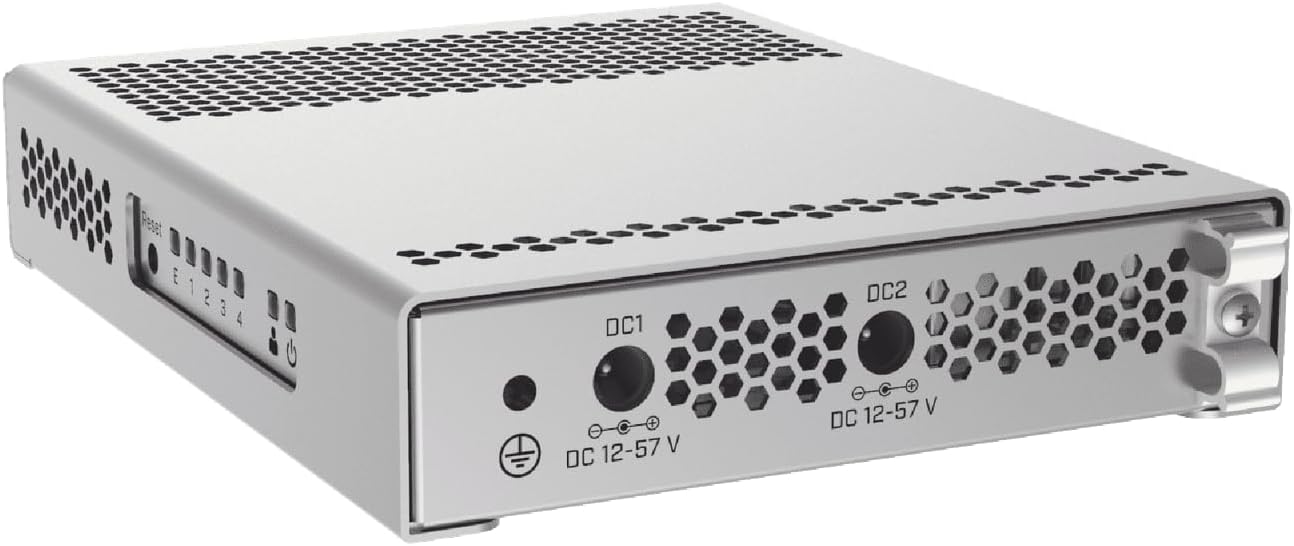

If you don’t want to mess around with direct/roundrobin connections and want a switch a switch, mikrotik is the most affordable at around $130. It should be noted it is NOT consumer friendly, and reading how to setup is mandatory.

Incidentally, the switch I linked is passive with no fans, so be careful where you put it. :wink:
Yeah, it looks perfect for my application though. A couple of hosts connected to a NAS.
