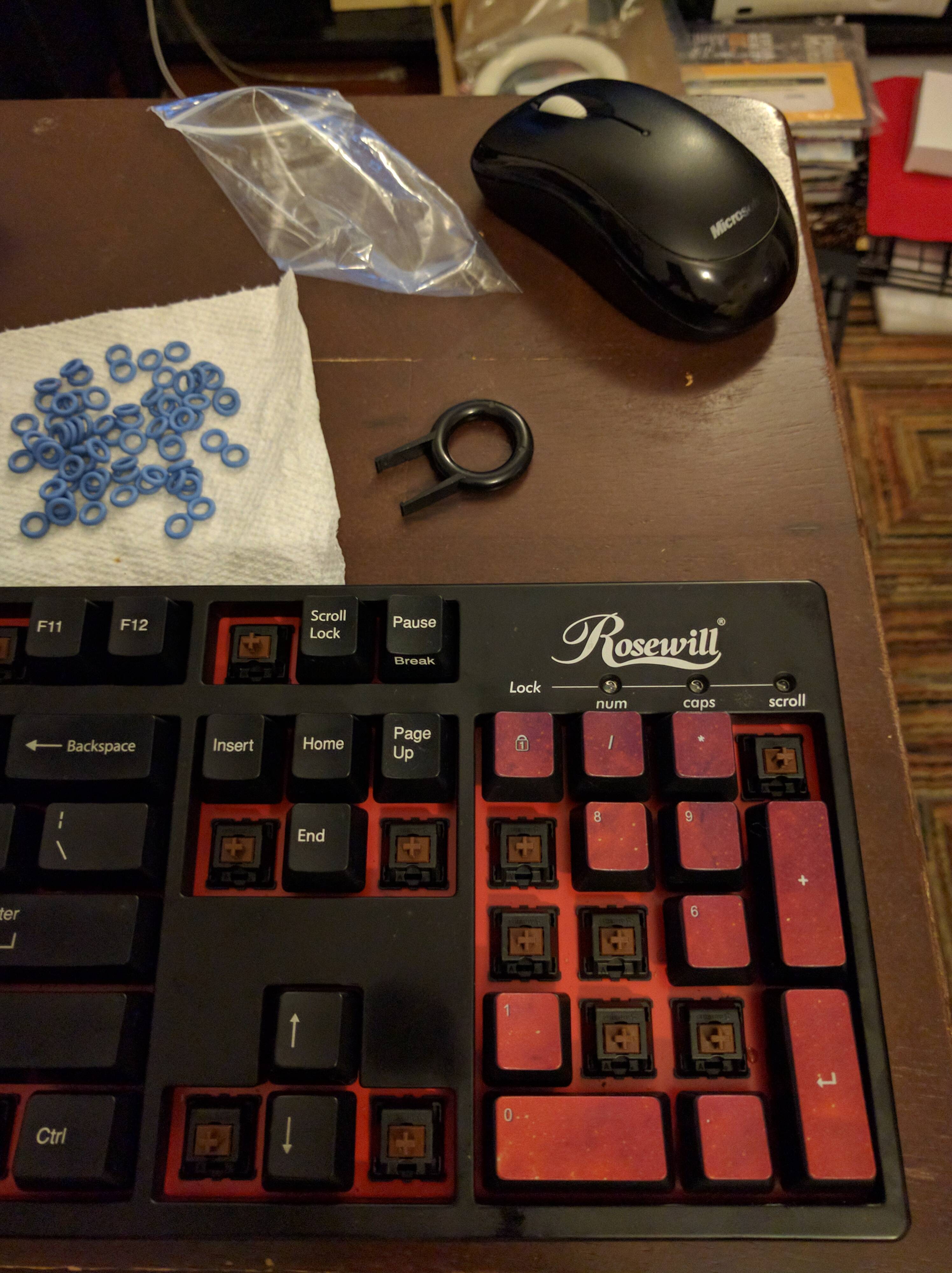

So here's where i hope someone can shed some light, what more can i do to make they keys quieter? the problem im having is not the key press but the key rebound making a bunch of noise. i currently have browns with the hardest, largest o-ring and the key rebound / release makes alot of noise. is there any inventive innovative solutions someone has come up with? looking forward to your thoughts kappa
Which mx type? I have browns so they aren't very loud but give the right about of feedback. Really the o-rings just help keep the keys from bottoming out thus making it quieter. I have my keyboard with o-rings installed and there's a noticeable difference. If you type heavily the o-rings will be very useful.
yeah it's the up-clack that's bothering me. MX-brown on my rosewill keyboard.

You know I have Blues so obviously the sound doesn't bother me much, but make sure your keys are properly lubricated. I had two keys which were not and they sounded much louder than the ones which are so that is also something to think about.
Thanks for the tips guys, I have blues at home and I love them but I use the browns at work and I want them as quiet as possible
Your best bet overall is probably a pack of o-rings, although they may still be a bit on the loud side.
