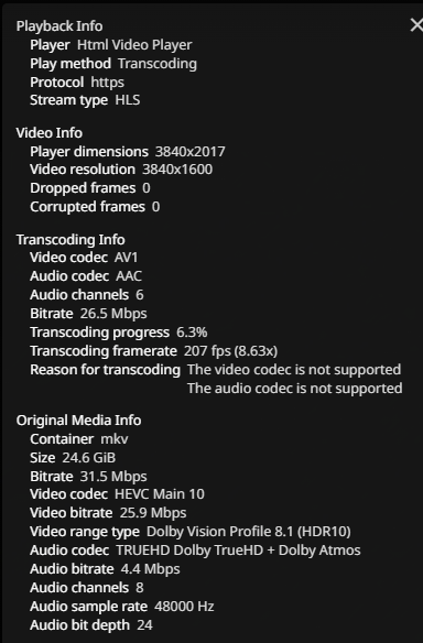

Personally use B580 (a bit overkill) for Jellyfin transcoding and it can handle multiple 4K 10bit streams no problem.
Looking at Jellyfin stats, it should be able to do 6-7x 4K 10bit streams at the same time, even more at lower resolutions. Also Intel doesnt limit how many transcode threads there are. Nvidia, i believe, limits it to only 2.
Not sure how plex likes Intel GPUs tho
B580 stats:
I think i had to add jellyfin to render group as well for transcoding to work, but i spent like 2 hours gettin it to work, to that may not be the issue i actually had :rofl:
Arc A310
