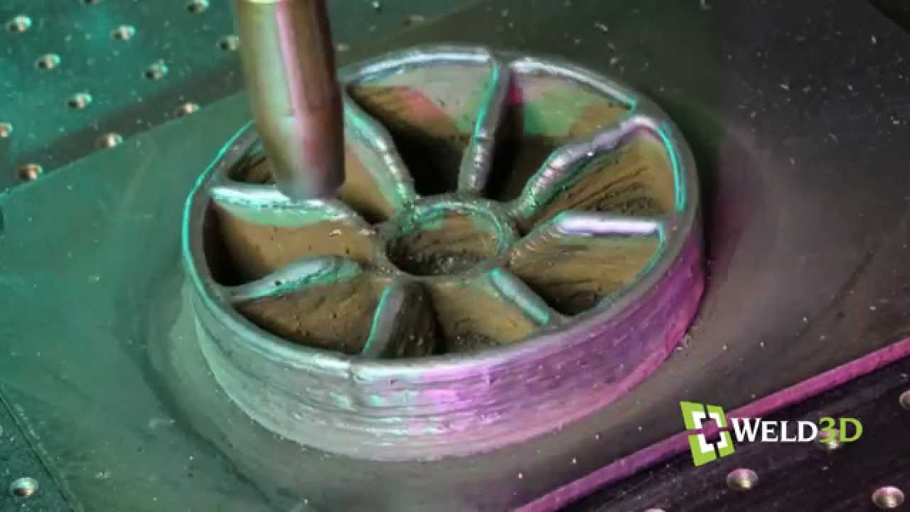

There are a few companies using MIG welders to print. They are pretty messy & very slow, but it’s probably the cheapest form of metal printing, its just a cnc welder, which have been around for decades.
this is actually sort of interesting. The first video you sent was a combination of a welder and a miller. This design of using a welder is probably not the best option for printers that are going to be small or anything.
But extruding metal as a FDM printer and then milling it may be a viable option to get rather good prints actually. Only problem may be that the print may now stick to the bed and thus will get thrown away by the mill.
