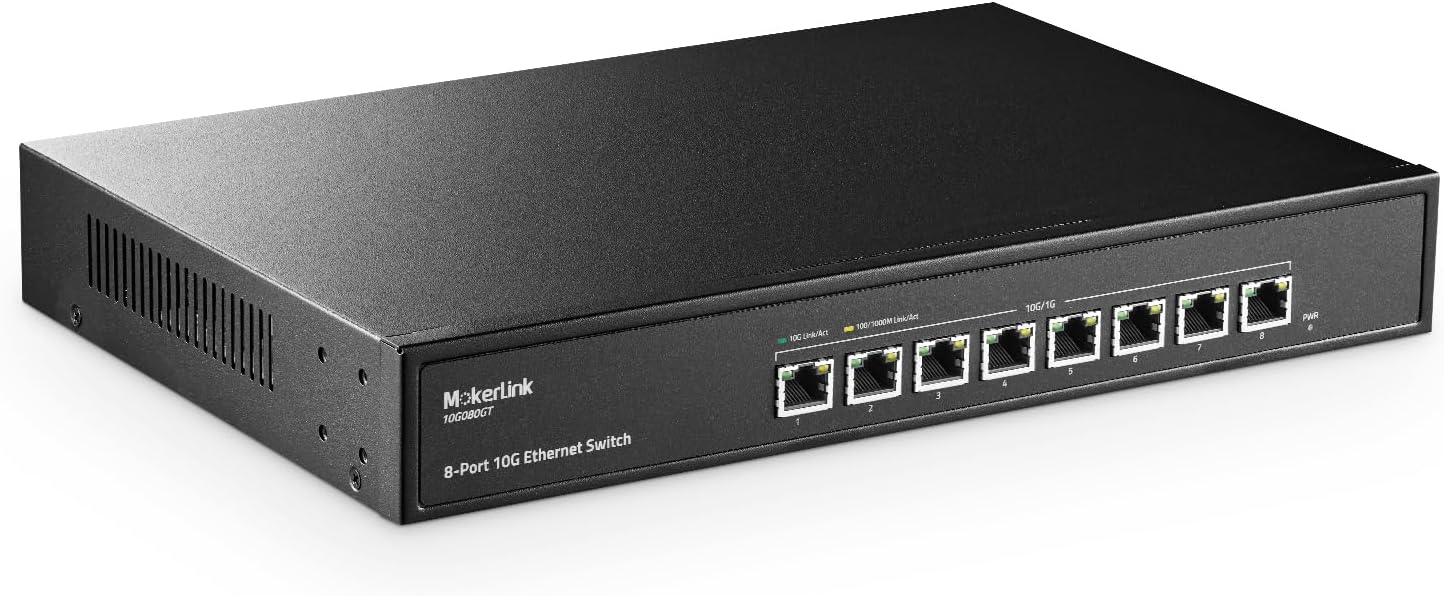

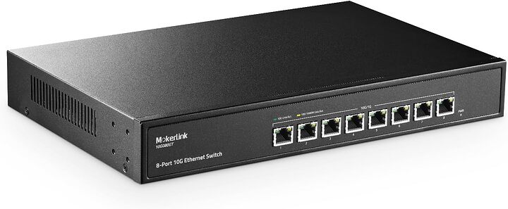

There is a switch on amazon that is 200 dollars for 8 ports x 10gbit rj45. The next cheapest of name brand (trendnet) is 330. How bad could the performance and reliability be for the non branded one?
It is unmanaged and would plug into my mikrotik switch.

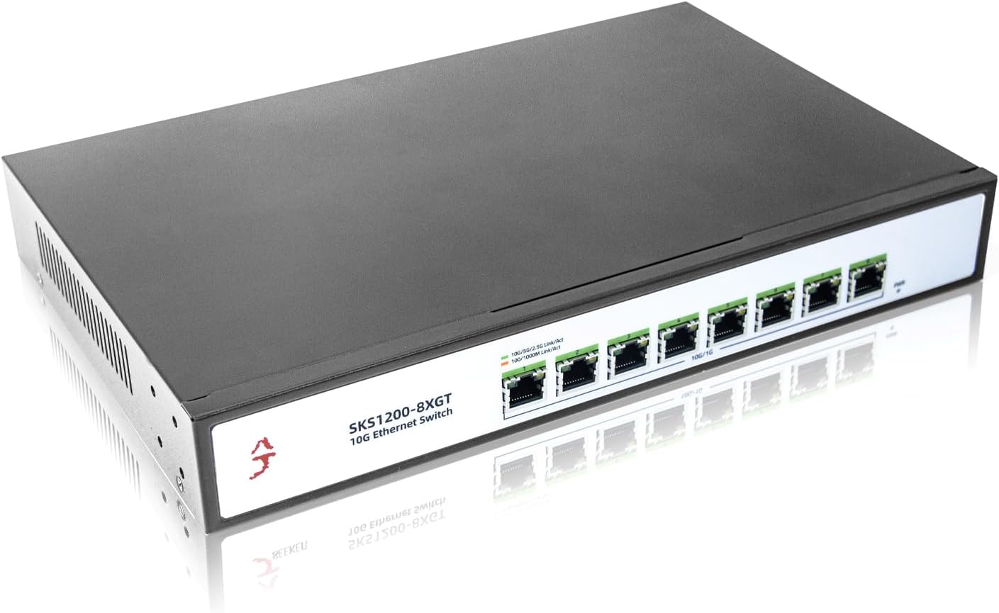

Here is another. More expensive but still cheaper than trendnet.

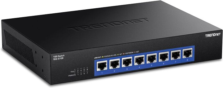

I will probably go for the trendnet then.
Trendnet is - while not one of my preferred brands certainly a bit more trustworthy than those Chinese brands.

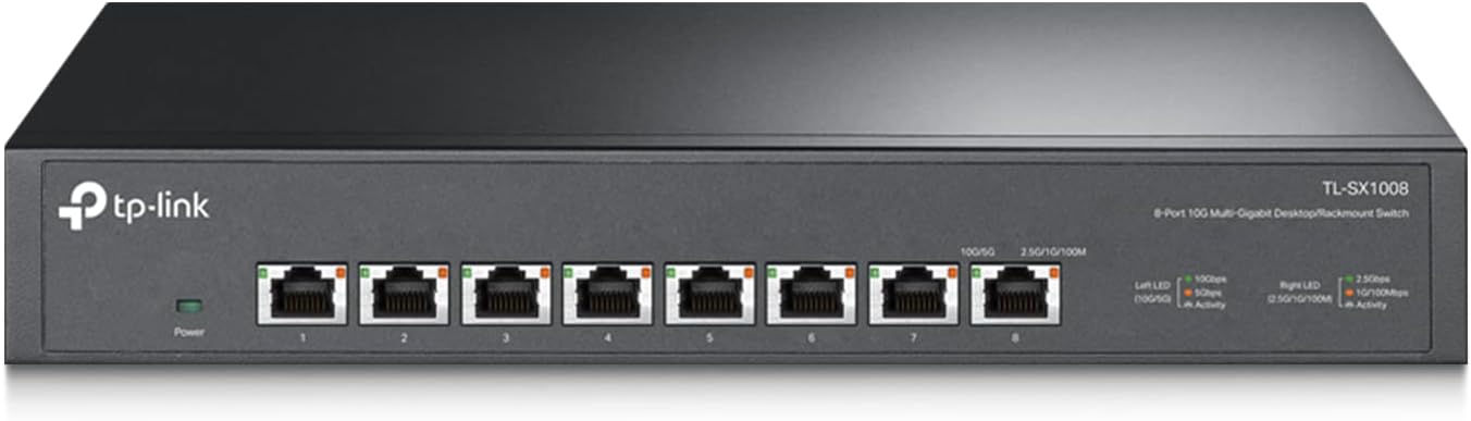

TP-Link has overall impressed me as of late with their products and support. I have one of their Layer 3 switches and a POE+ switch and they have both been solid over the last year.
