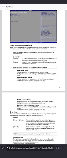

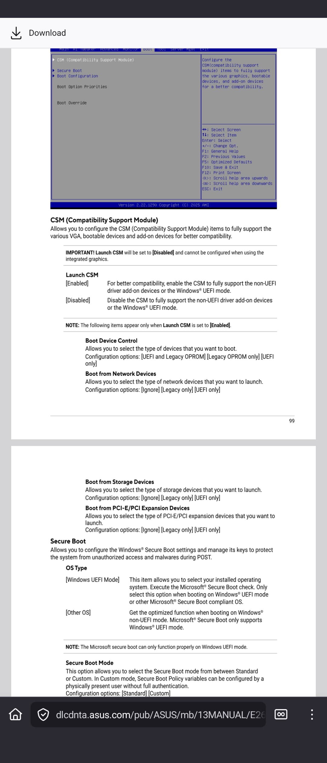

Not in Charlotte, but I think I had the same issue before. Have you tried disabling secure boot if you are doing an initial setup?
Failing that did you enable csm? See the boot section of the manual
Hey bedHedd, thanks for your reply. Tried. Yes and Yes. That’s exactly what ASUS support suggested as well. No luck. They also suggested using an older OS version then upgrading once installed. No luck.
