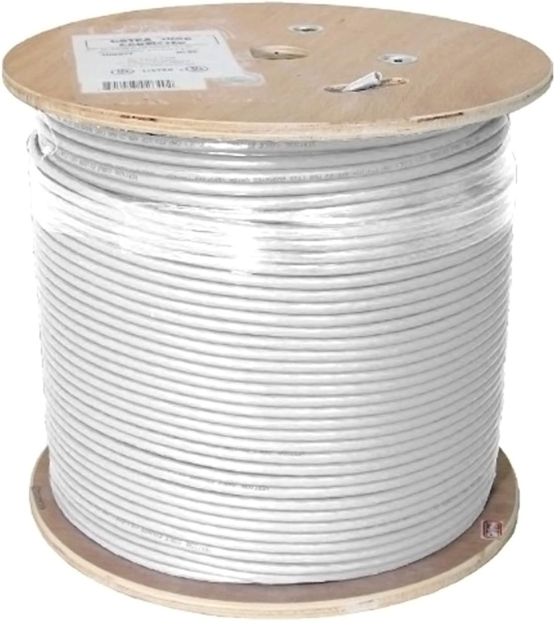

On a related note, does anyone have a preferred bulk Cat6A UTP brand? I’ve used the Monoprice one in the past but it is ridiculously thick (23AWG). I’ve seen some “ultra-thin” Cat6A listed at 28AWG, but I’m hesitant to pull the trigger on it having never used it before… For Cat5/6 I like Sewell, but they don’t make 6A.

Recently used this on an install and it was amazing.
How thick/flexible is it? The Monoprice stuff was like f-connector coax. A real pain to run.
Also, do you know of any boots that fit it? One end is going straight into a switch (no patch panel).
This stuff is riser rated, its quite malleable. The ‘stiffness’ is usually due to the plastic spine in the cable and not the AWG rating. To give you reference, this cable is not as stiff as RG6.
It is also true solid copper, not CCS. This adds to the stiffness, but they are just above stranded cables in that regard.
