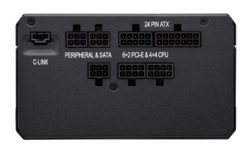

I have a 290, which needs both an 8 pin and 6 pin input. Currently, I have a cable that is split on one end to both an 8 and 6 pin connector, and I plug that in to the 8 pin PCI-E port on my PSU. I only have one labelled PCI-E port on my power supply, the rest of the empty slots are labelled as SATA and Peripheral.
My question is, could I use two separate cables; one an 8 pin to 8 pin cable plugged into the PCI-E slot on my PSU, and one 6 pin to 6 pin cable plugged into the Peripheral slot?
Here's a picture of the front of the PSU and here's my build spec.

You cannot connect the peripheral connectors to anything other than their stated devices.
The 8/6pin for the PCI-e consists of (for 6 pin) 3x 12v and 3x Ground and the 8pin having an additional 2 grounds (used for sense purpose)
The peripheral connectors have 1x12v, 1x5v, 1x3.3v and 2 grounds.As a result they are not pin compatible in the way you desire.
