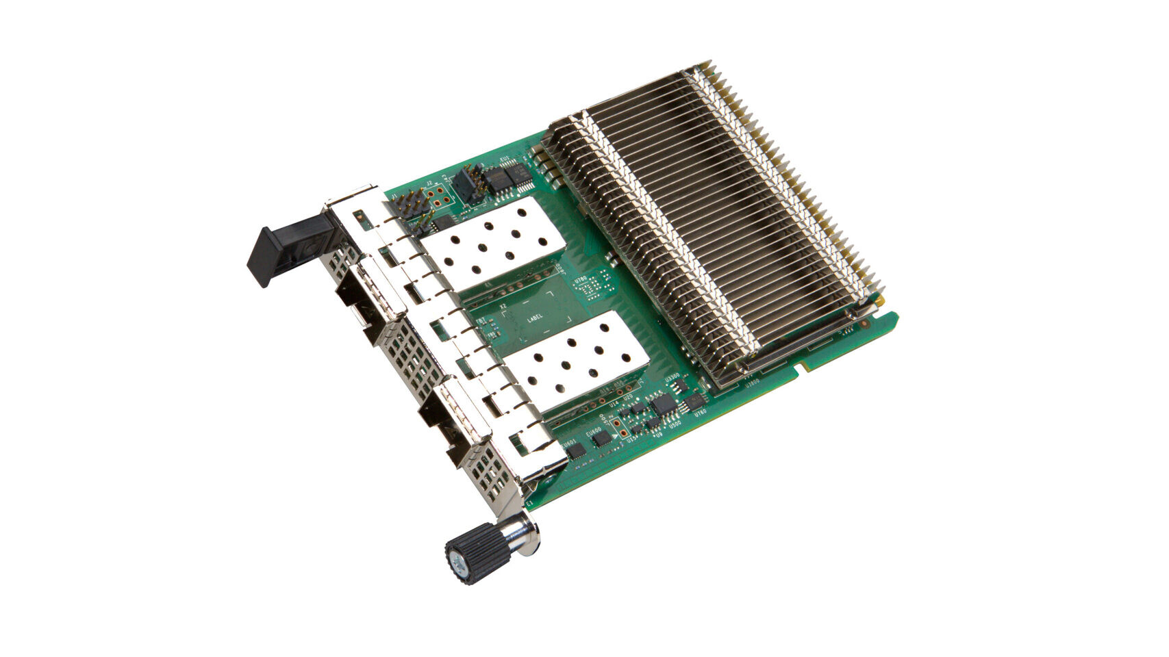

Sky has fallen and intel is presenting new E610 family of ethernet adaptors. 10 gb + multigig and supposedly power efficient. Zero details though, servethehome will likely do some testing once they are available.
I did not expect that, lets hope it will not be another buggy mess.
EDIT: found product brief https://www.intel.com/content/www/us/en/content-details/836469/intel-ethernet-controller-e610-xat2-xat-iat2-product-brief.html
Controller itself is supposed to have maximum power consumption of 4,5W, wchich is extremely impressive for 2x10gbe capable card.

Found second source on power efficiency claims from lenovo writeup:
Low power consumption
With an absolute max power consumption of 5.2 W, the dual port E610-XT2 represents a 45 percent reduction in power compared to the Intel X710-T2L, and a 60 percent reduction in power compared to the Intel X550-T2.
ref. ThinkSystem Intel E610 10GBASE-T Ethernet Adapters Product Guide > Lenovo Press
Looks like a first offer poped up in Germany this week and the price is not encouraging:
for 2 port NIC (E610-XT2) it’s 356.61EUR
for 4 port NIC (E610-XT4) it’s 629.02EUR
… X550-T2 cost around 120EUR right now. I hope as more offers appear, the price will go down
