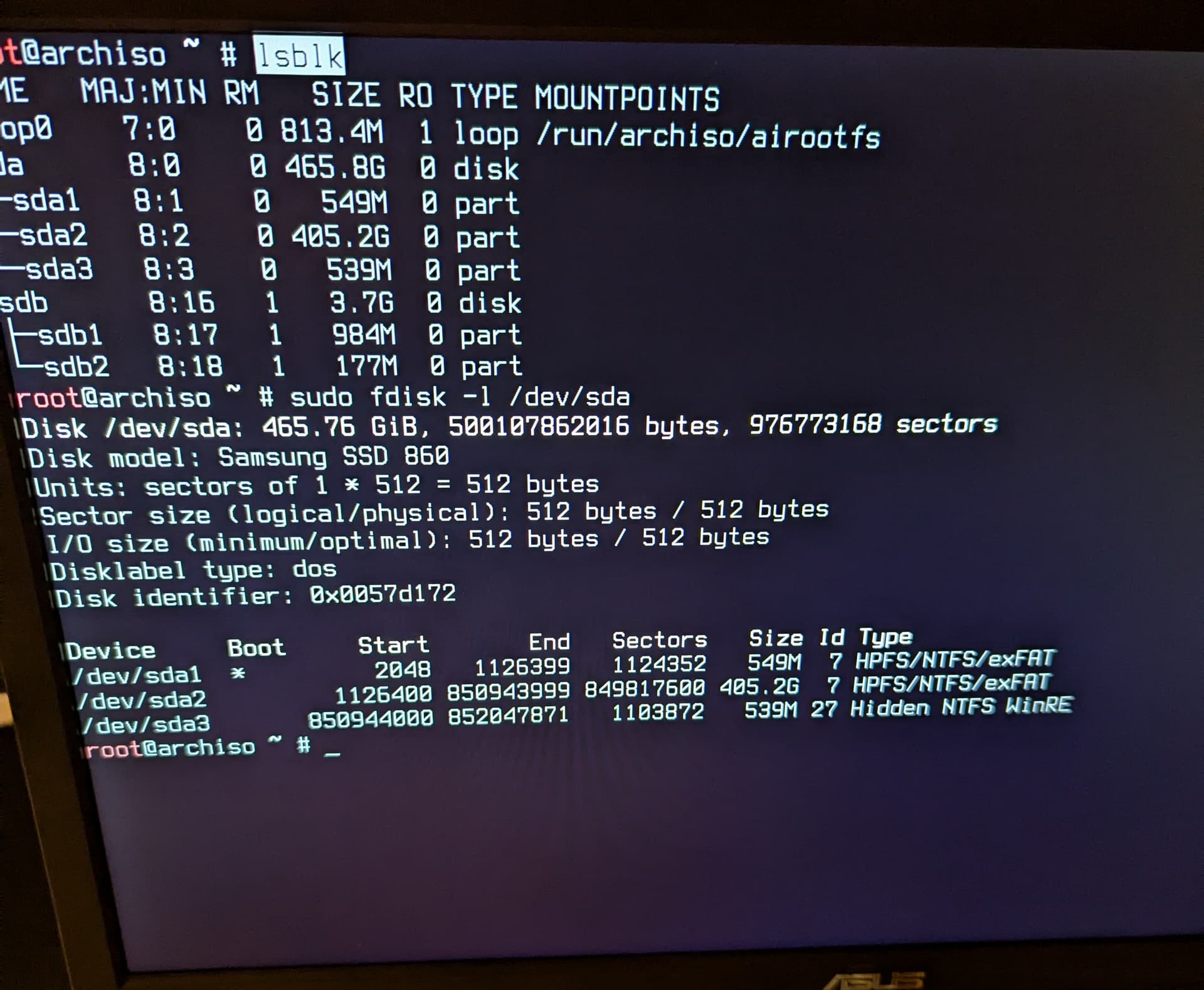

Still struggling to boot my Windows SSD but I was able to confirm that the computer can at least read partition info as pictured from that SSD.
When I tried to boot the SSD, now the screen is completely blank with no top left dash, and the CPU fan occasionally spins up fast. Going to look into using the Windows Repair USB next.
