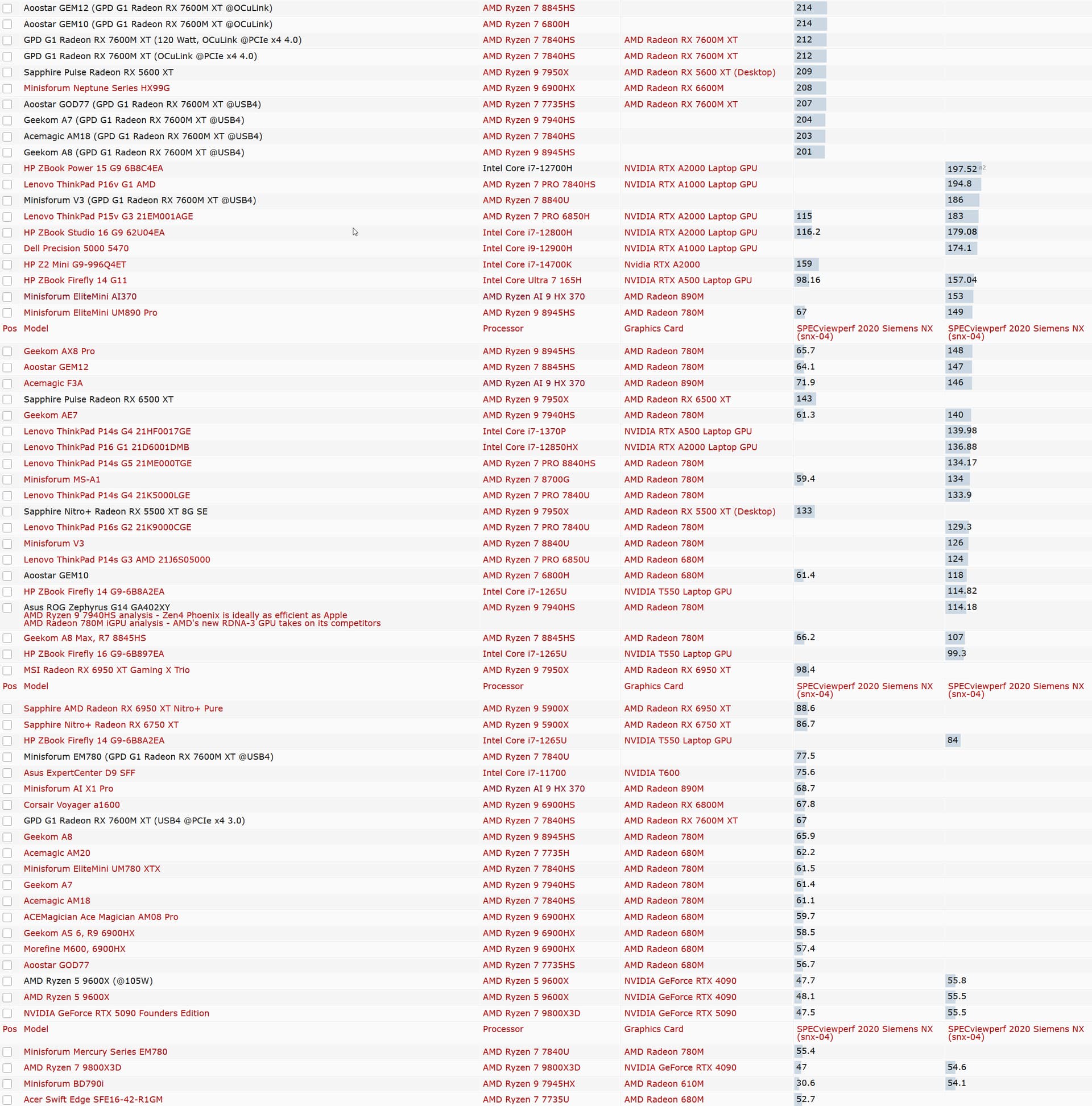

What do you need the GPU for? If it’s for cad then a workstation gpu will be much faster in NX, (but not for example in inventor). The raw performance is not indicative in performance. But if you only make small models it would be fine to have a slower gpu.
In NX, amd gpu’s are actually faster than geforce gpu’s compared to raw performance. I think it is because nvidia specifically only targets quadro’s with some optimisations.
A desktop RTX 4090 is slower than integrated amd 780M or slowest quadro. As for cost effectiveness, a RTX 1000 ada / 2000 ada or the 7700S in the framework 16 would be a give good performance to cost ratio. the RTX ada a500 would also be much faster than the Geforce options you have.
The data is interesting, can you share where can i find more of those benchmarks you posted?

this is from notebookcheck, nvidia studio drivers do the same thing as normal geforce drivers, just slightly more “stable”. they don’t give any different drivers for applications than a geforce driver.
you mentioned those results being fine as well, but it can drop down quite a bit more if you go into geforce gpu’s.
