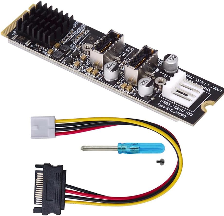

product heads up
using debian linux(bookworm/12) this device worked fairly well. notice that i am not sure if wiring issues i had were related to this device or the cheap cables ordered to bring the type-c connectors out at the pci slot. software wise, it worked great with the elgato cam links that was used(only 3.0/5gbps devices). also, beware… there are a few “manufacturers” of this device, but if you look at the device they are identical.
edit: so generic in fact, i posted the wrong link
