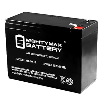

This battery should be ok I only need 5-10 gallons tops so I don't need anything too large.

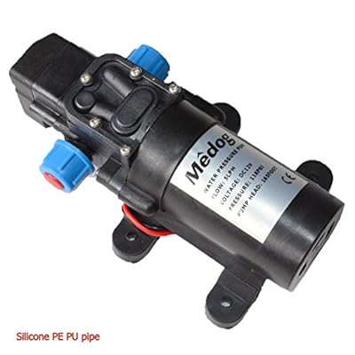

Unsure of what pump to get my considerations are below,
These diaphragm pumps seem like a good option as they seem to be the cheapest capable to doing the job and as a plus have a pressure switch so all control can be handled with valves.
I will be adding an inline filter to hopefully remove any partials large enough to damage the pump
it has a head pressure of 165ft so it should do the job.
The only issue is it dose not specify if it is self priming or not, some people in the reviews say it is and some say no. So with the assumption this dose not self prime how do I deal with that?

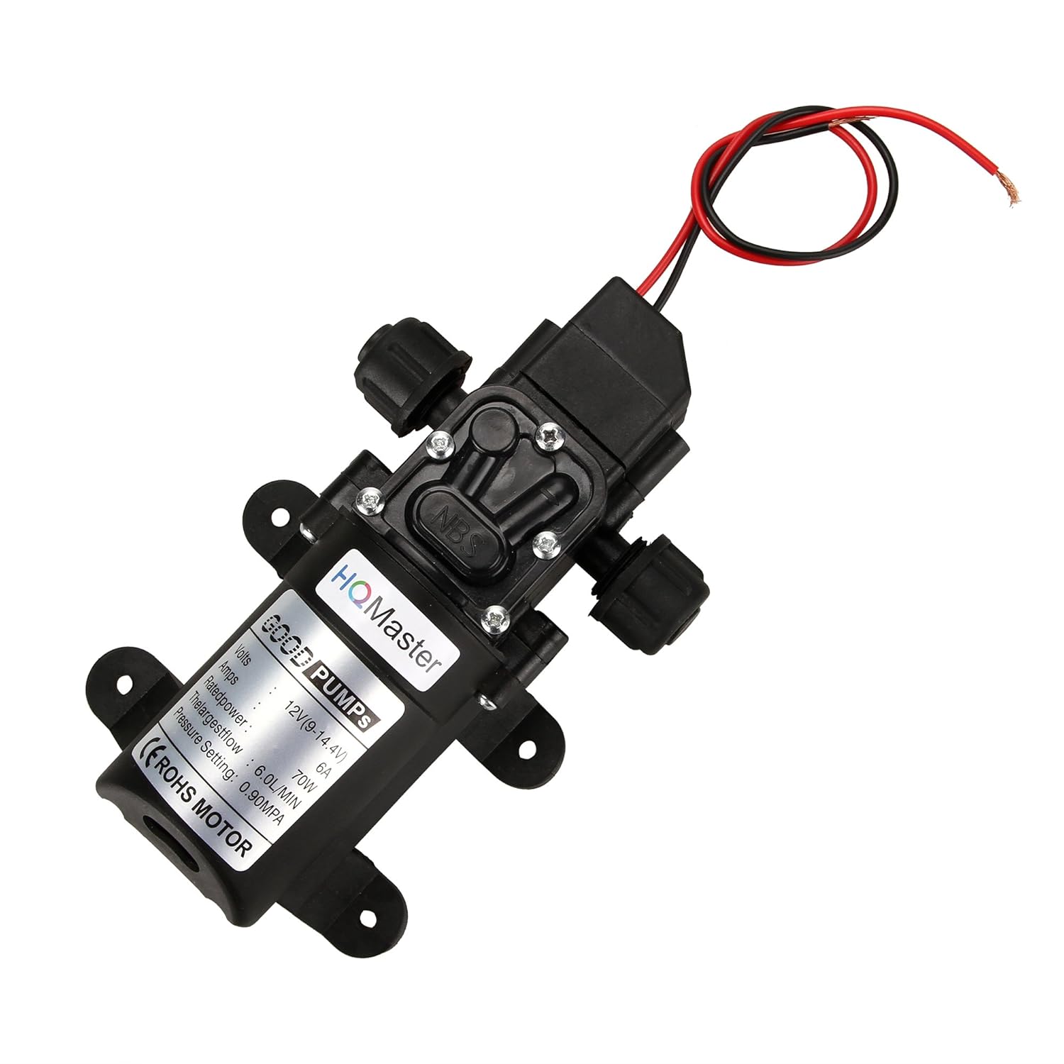

This one has a supposed head pressure of 90 meters so that is also plenty and it is self priming but the reviews are pretty lack luster so a dubious option at best .
this one is rated ok who knows
cheapest I found with appropriate ratings
I've never actually seen those pumps used for irrigation before. They are used for fertigation when you need to inject a precise amount of liquid fertilizer over time, into the irrigation water pipeline (which is already under pressure - that's why these pumps are rated for such high pressure).
I guess they might be OK if you're going solar, and pumping to a container placed somewhere high to give you enough pressure for when you irrigate later. And if you automate everything so they can pump whenever there's juice, since their flow rate sucks... Another plus would be that you distribute the effects on the groundwater table over the whole day.
These don't seem like they could handle irrigating for a whole season. But they are extremely cheap for what they offer so there's that.
No idea about the battery, though...
Prime by setting everything up and filling all cavities between the surface of the groundwater and the pump's outlet with water. That means: a completely filled inlet hose and the pump cavities. Outlet hose can be filled too but it's not a requirement.

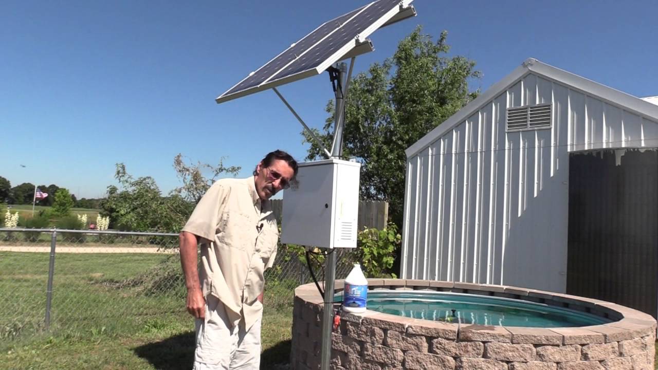

This is a bit different, it's a video on pond aeration, but you could easily substitute a 12V pump in place of the aerator that has a 15 foot head rating. Anything solar and wind, this guys channel is very educational.
wellp setback, I tested the pump and with the pump mounted high it cannot pump water higher than a little under 9 feet. looking at the ad they claim a suction height of less than 2 feet but a Max Head of Over 150FT so that complicates things a bit. I need too suck so I don't think any of the pumps I was looking at can do it.
