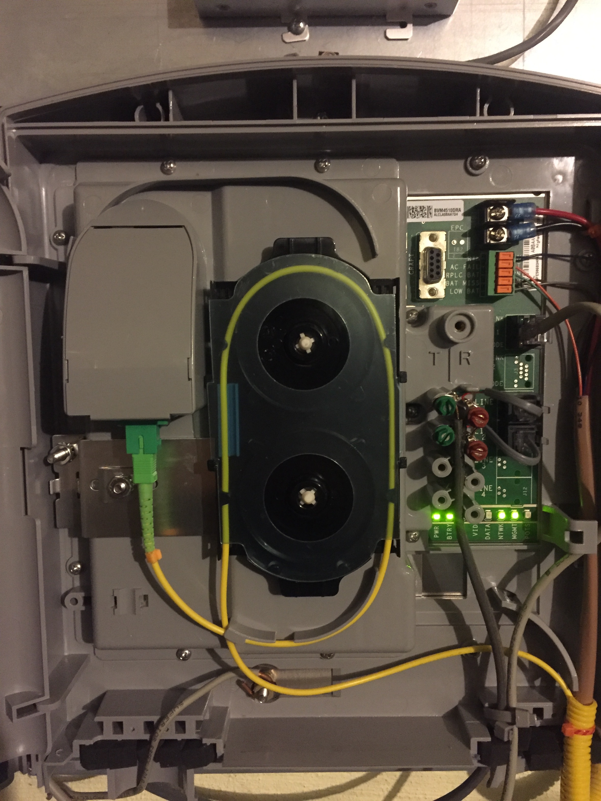

Setup went without a hitch, I configured the NICs for my WAN and LAN, setup my old router in access point mode, and was super happy with it. That was, until I noticed the link from my fiber box -> my pfSense box was only running at 100BaseTX. I went to configure the WAN interface and decided to change it to use 1000BaseTX. I did what was shown below. (yes, I saw the warning, but from what I read it was only an issue that would affect speeds) After I did this and applied the changes, my WAN connection coming from my fiber modem just went blank. I couldn't get any lights on the connector to show up, no matter what computer or device I plugged into it. Here is a picture of where the cable hooked into my router hooks into the fiber modem: No lights, nothing to indicate anything working. None of the devices even recognize they're plugged in either.
A technician is coming to fix this tomorrow, but I'm really just looking into getting to the bottom of this. Is this some kind of protection feature on the fiber modem? Or did I actually just do something really wrong. If anyone has any input on how stupid I am or what they think happened it would be greatly appreciated! I can supply more pictures if anyone would like since I'm only able to add two per post.
Do you have AT&T? If so it looks just like an older model modem we use and they'll probably put in a new one since that one got phased out pretty quick.
I've tried 3 different ones, and I've validated each work. None of them produce anything different. They installed that cable when the modem was installed, and ran it through the ceiling making it pretty hard to replace.
can you get a gigE link out of those pfSense ports if you use a crossover cable or plug into a gigE switch? can you get a gigE link out of the fiber modem if connected to a gigE switch or differnet NIC?
I was probably unclear but the issue isn't being forced to 100Mbps anymore, it's after I switched it to use gigE, its completely dead now. I can't get to work at all now on any device.
I have a tech coming tomorrow, I'm just trying to figure out why/how this happened.
