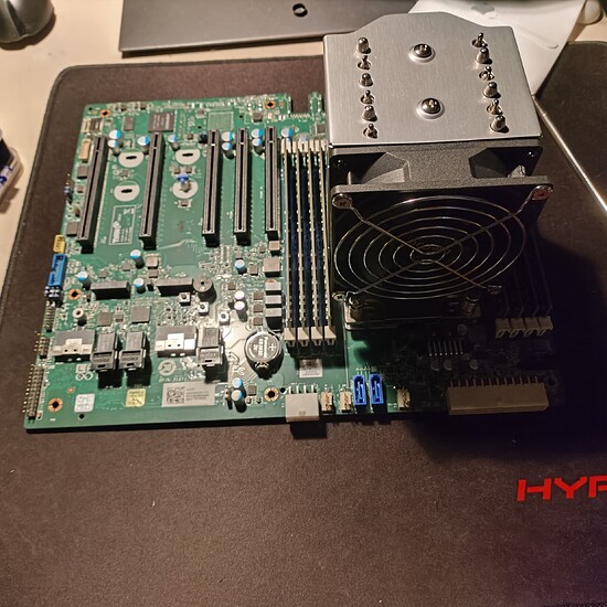

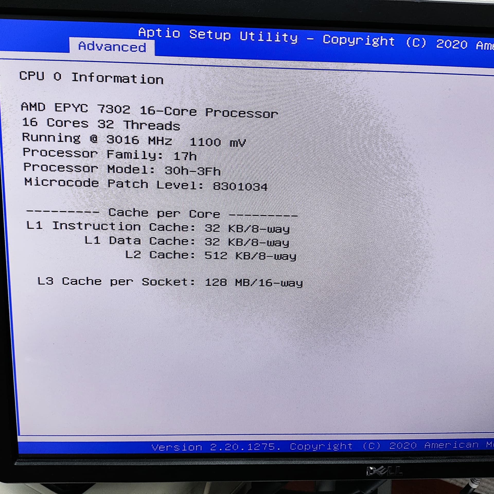

Some SM boards dont have specific cpu fan header so it should boot up but its very risky! i mean super risky! its not a normal pc board that you get ram check after 5sec. its gonna be at least 2min until you can check the ram.
All CPUs can run for a little bit without a cooler, I think as long as you do not leave BIOS it should be fine. Be exceedingly careful though, and do be aware you are running out-of-spec.
Adding a fan blowing right at it would be possible, it’s just the radiator itself i’d be missing for tests (not anymore).
The question was, considering EPYC’s requirements for specific mounting pressure, would it even start with no radiator applying pressure on it?
The most we would be able to add to the cooling - is unbolted LGA3647 radiator put on top of the CPU.
I think that could be the case because they probably designed around it. There are so many LGA pins on it that if you look at the force you need per pin. and multiply that with the number of pins you get a really high force.
That force will create a slight bend in the heat spreader and PCB because the bracket is only on the outside edges of the cpu. So you have a chance that the pins in the middle don’t make good contact. I wouldn’t chance it!

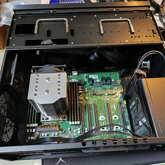

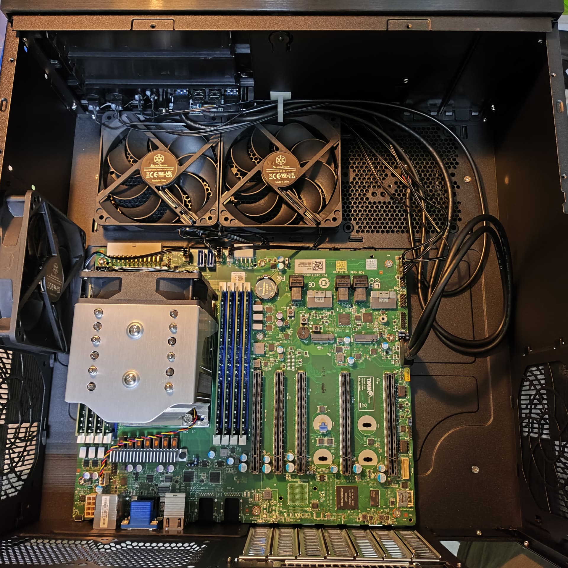

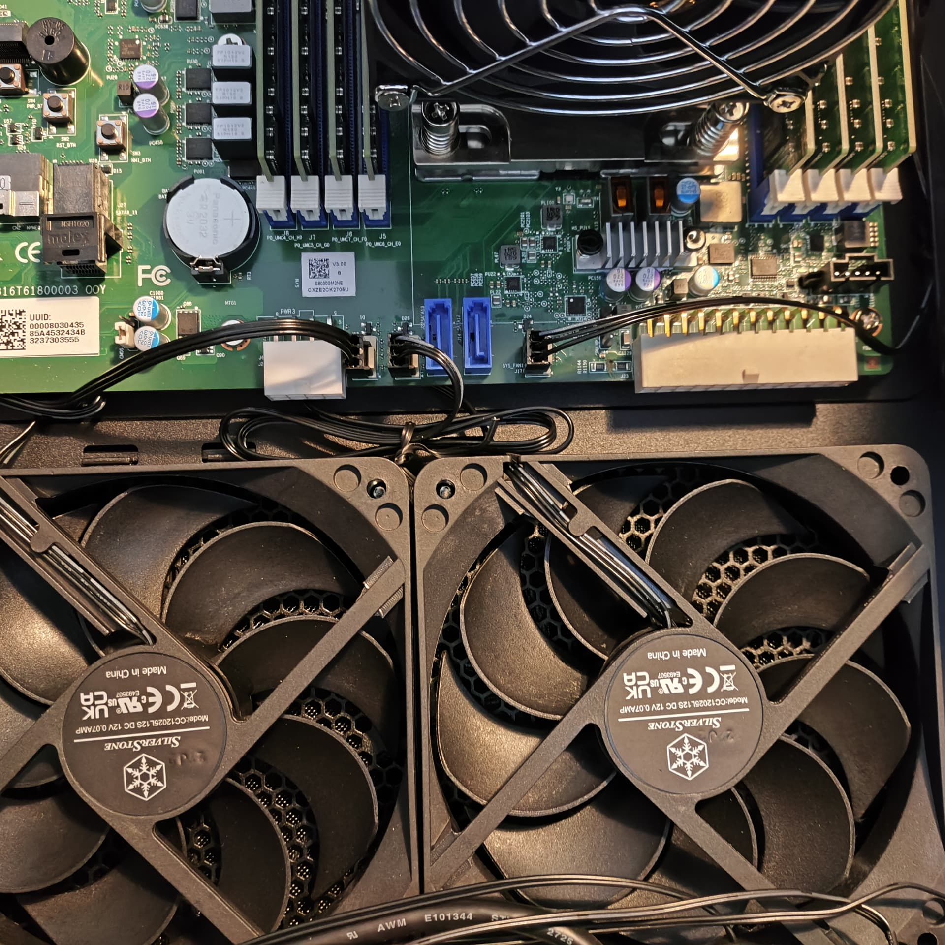

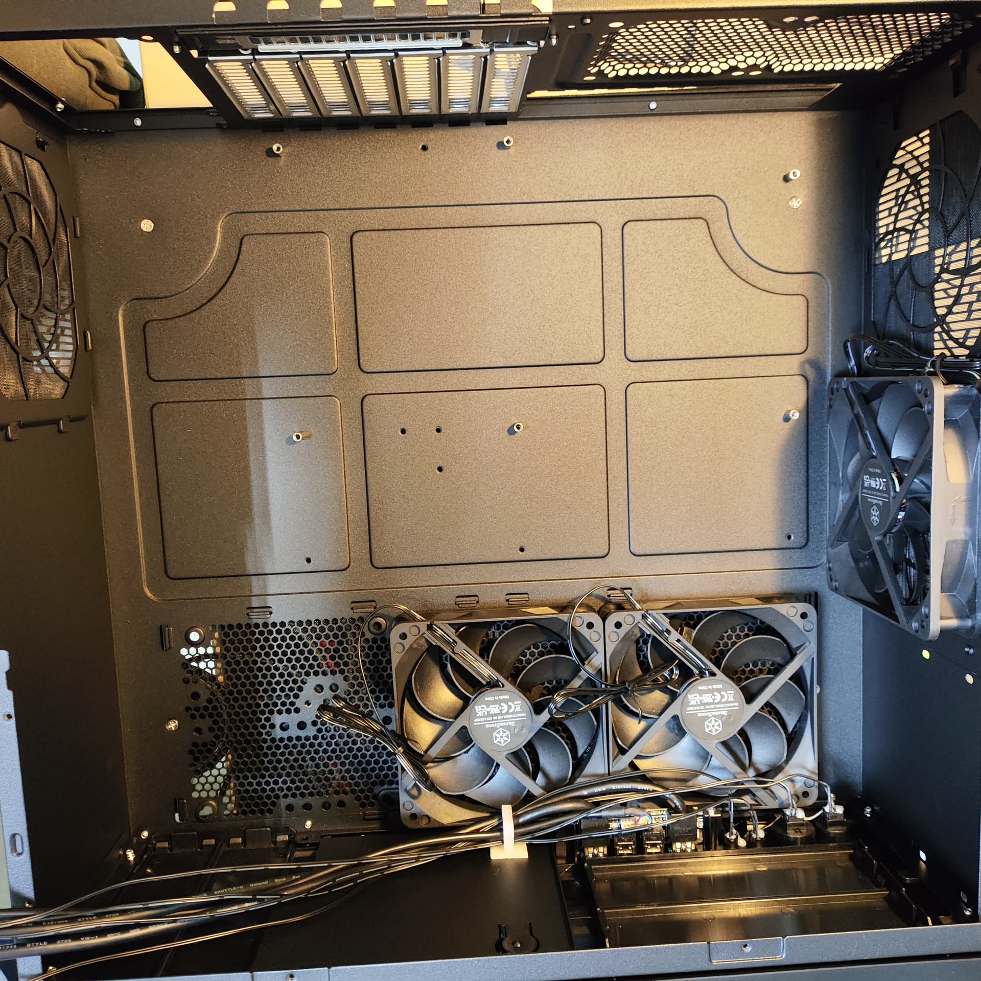

To nobody's surprise - the space between the ATX power connectors and the 120mm coolers is barely there:
Right now i’m interested in variants of how to fit the ATX power cables there.
- Use 90 degree adapter, and just redirect it upwards again
- Use lower-profile coolers, like 10mm or 15mm tall. Maybe these will have enough clearance for the cable to fitover them.
- put the fan on stand-offs, route the cable between fan and case, close the gaps between fan and case using duct tape
For the power cables - these are gonna be quite tall. And then it’s gonna interfere with front panel cables (they already block me from installing a grill on the fan without cutting it), or with the HDD cage. The easiest way would be to get 80mm coolers, which are 15mm tall, but at this point i really don’t wanna spend extra.
Radical mod would be to replace the motherboard connectors.
Also, the problem is with fitting the solid connector part inbetween the motherboard and the fan, not the cable itself. There’s like 1-1.5cm gap, which has to fit the connector and some room to bend the thick cable.

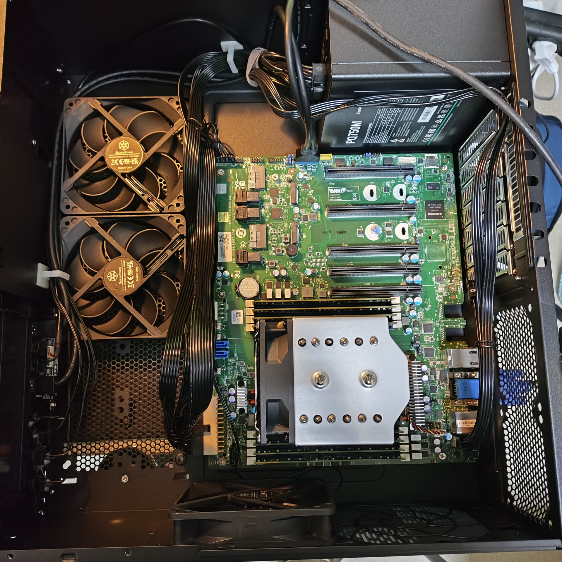

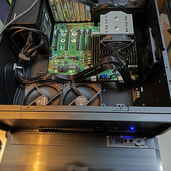

Now we’re talkin’! Got meself Deepcool PQ750M and now server has power! Alas, no storage yet…

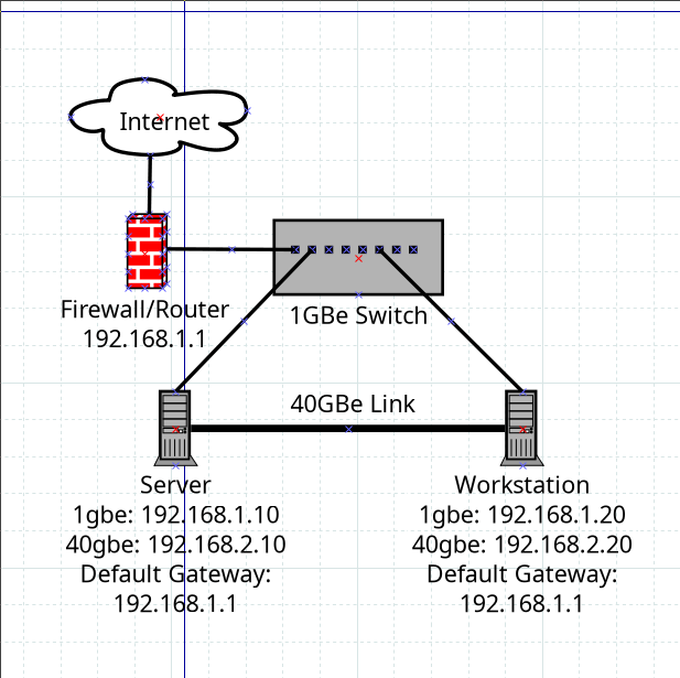

Lets assume this topology
If you want to talk to the server over the 40gbit link, use the 192.168.2.0/24 network. All other network traffic that goes off net (ie, anything except for 192.168.0.0/16) will go to the default gateway at 192.168.1.1 over the 1gbit link.
There are ways to keep them on the same subnet and assign the same IP to both network interfaces, but this is more complex and in your case, likely not worth the effort.

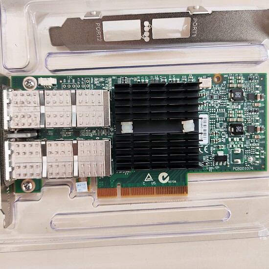

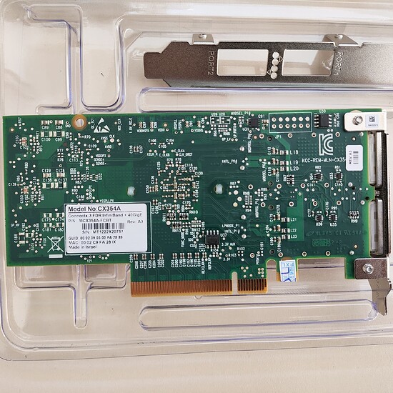

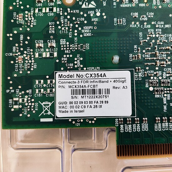

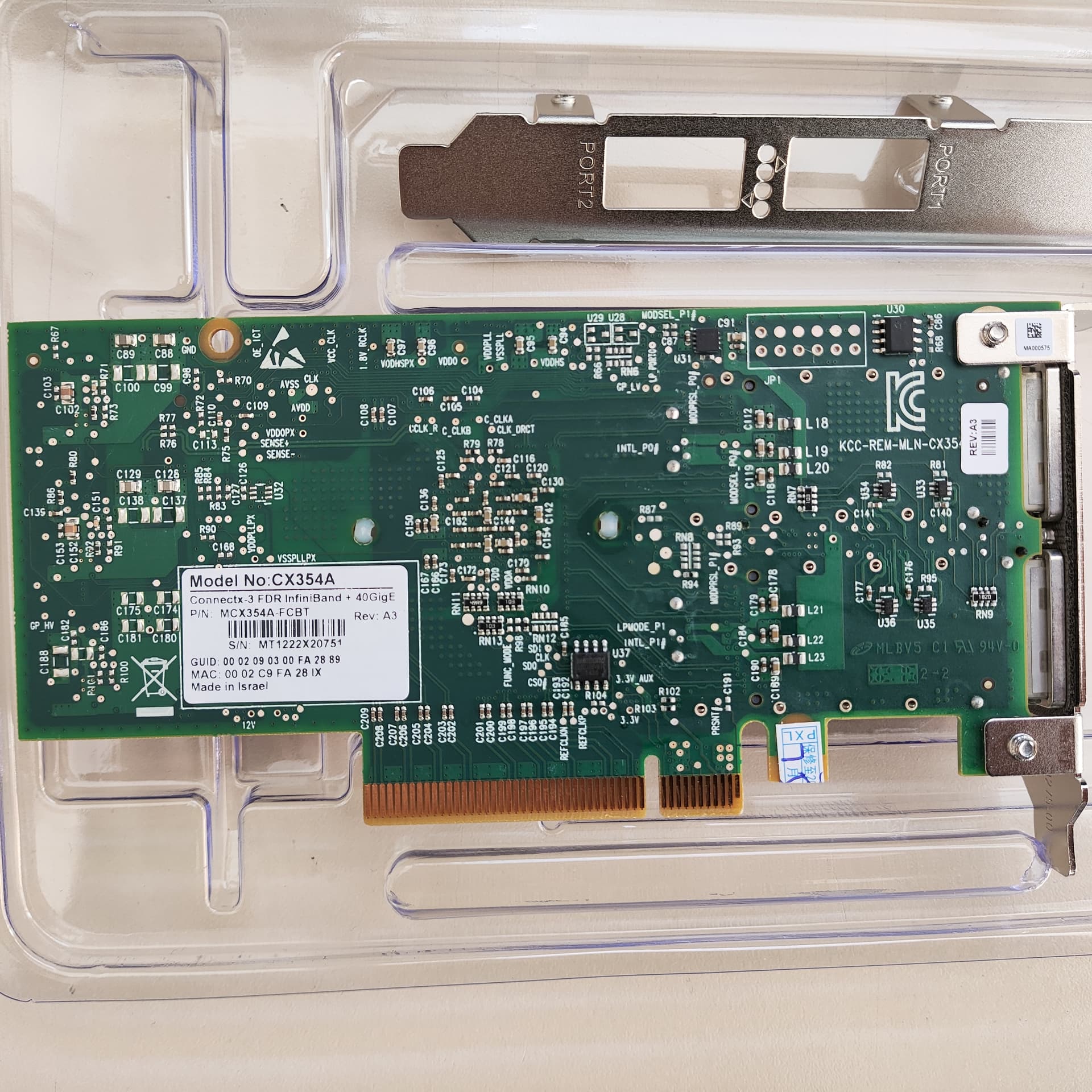

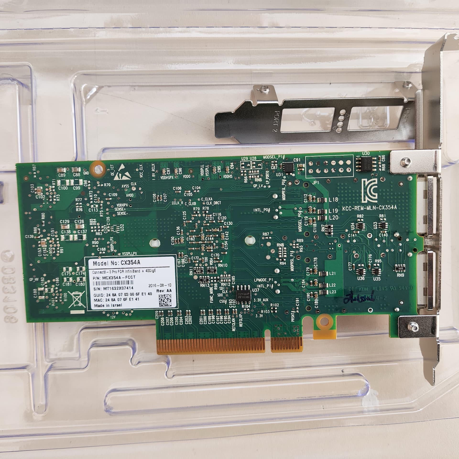

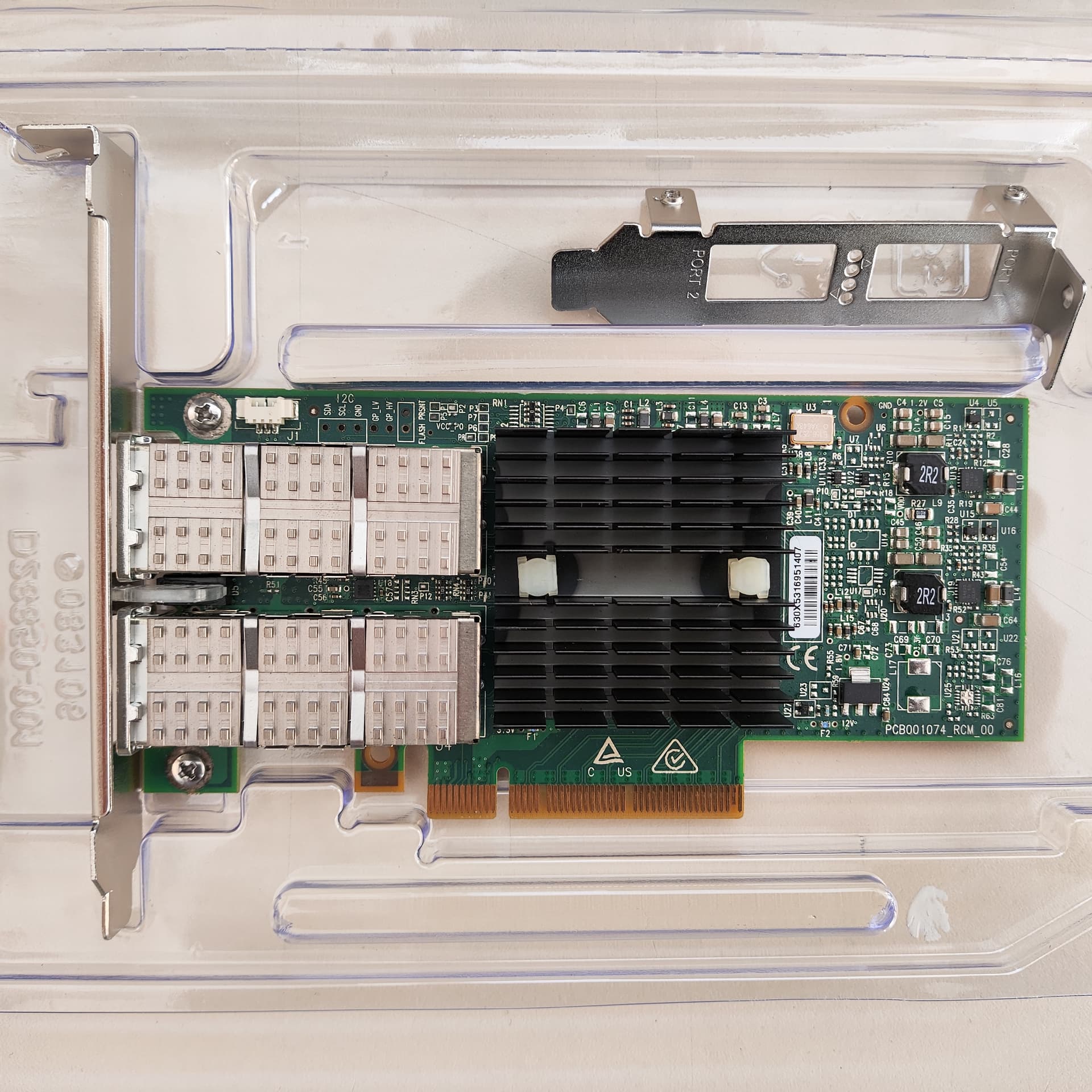

Got both Mellanox cards today. One is gonna be running at Pci-e 3.0 x4 though. All got detected with the now-Nvidia drivers.
Aaaaand i’m rekt. Apparently, ConnectX-3 don’t relly love running in P+E-cored systems, so i get a BSOD of mlx4eth63.sys every time i try to change the port protocol.

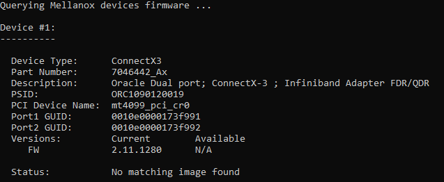

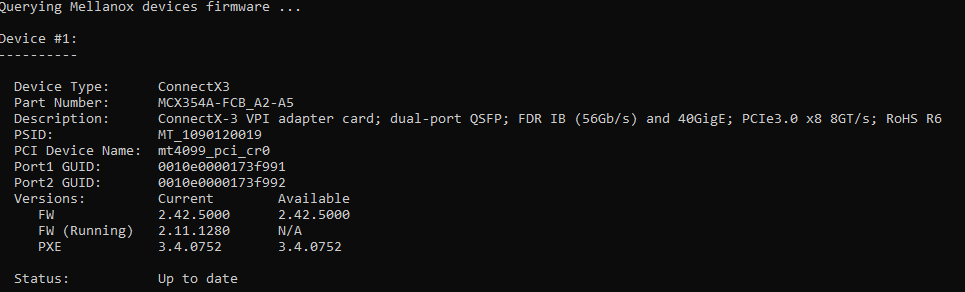

Checked the firmware on both cards:
Pro one had it alright
Regular one was vendored
After a succesful reflashing - it changed to this
Since one of the issues with BSODs could be me having P+E-cored CPU - is there any way to lock the card to specific cores? Or, at least, the driver?
