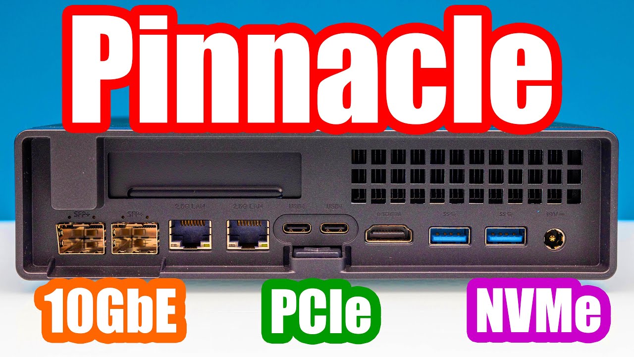

Check out this one, Minisforum MS01
This came out after I built mine… would’ve tried this one first for sure
