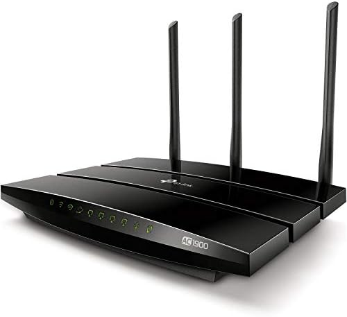

If you want to do this with 3 of your own openwrt configured boxes… I suggest
Both are in your price range. Do you understand the endeavour you are about to partake on? I did so . Can tell you it was very frustrating for a while. I often needed to bounce ideas (such as @Novasty) off fellows that understood it better than I but in the end I have a strong protected open firmware setup. (not necessarily a requirement)
If you understand this and want to do this… then go for it. I am just stating that you spent a lot of money on those google home devices only to toss out 99 percent of their functionality. I just want to make sure you are completely informed.
If you wish to do it with your existing google homes, you will need to bridge mode behind the firewall. You will need to place the switch between the firewall and your APs. Your APs will be a 2000s era mesh as discussed earlier wired into the dumb switch and pointed to a default gateway that is your protectli OPNsense firewall. You will then lose access to their interfaces so be sure everything you want set is set.
