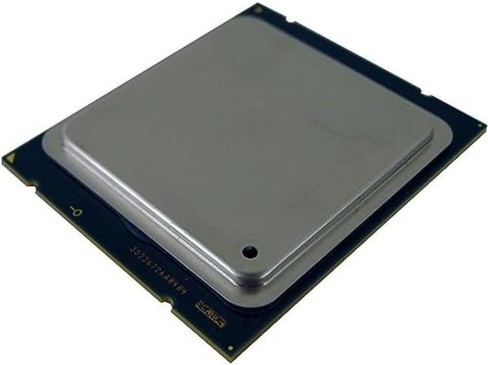

Much like you @Blanger I kinda stumbled upon that processor,
http://www.newegg.com/Product/Product.aspx?Item=9SIAAEE3YG0676
which looks like it supports virtualization and I double checked it here:
I eventually stumbled upon this article here:
This kind of led me to check prices on ebay which appears even cheaper. I do know this is a v2 version which seems to be the only one at 2.6GHz. The performance seems to be about the samish as the i7 processor I was looking at earlier.
