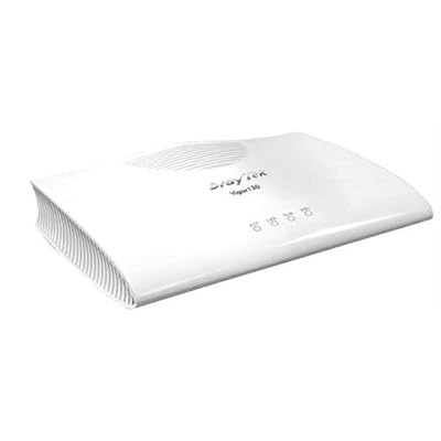

I use this for a modem
DrayTek Vigor 130
It's absolutly rock solid, it never fails me.
