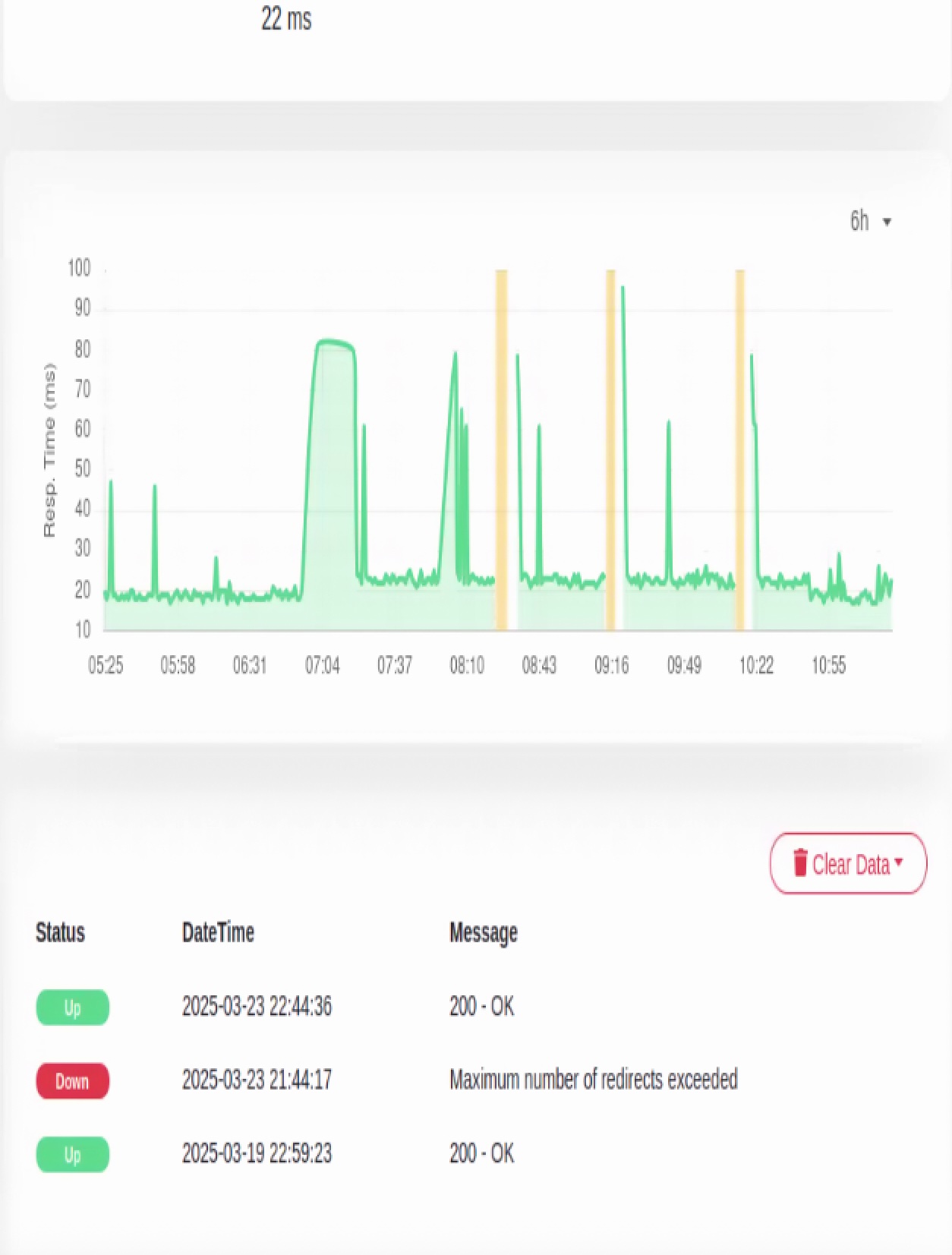

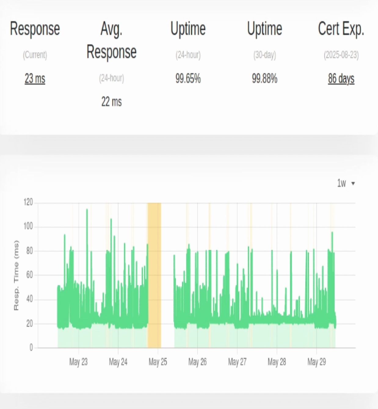

On the other hand, Uptime Kuma over the last week shows the attached logs for Node1. This shows more yellow outages than the Proxmox logs report, so maybe they aren’t telling the full story? I am just reporting the ones shown in the Proxmox Web GUI…
Hopefully with this more detailed overview of my setup you can offer some insight into what I can do to debug this? Thanks again for your help!

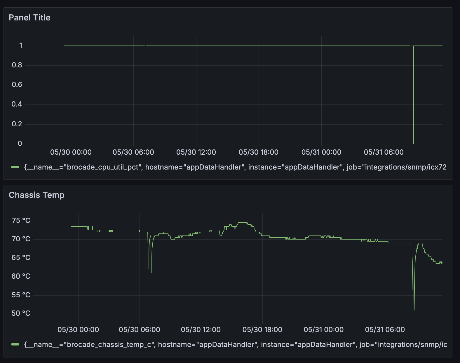

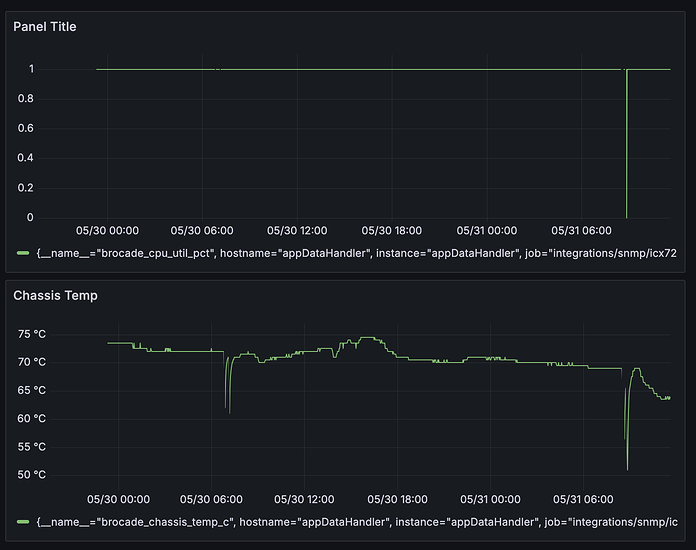

I removed the transceiver and have started monitoring temperature and CPU stats via SNMP over this time:

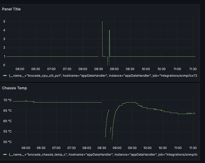

Zoomed view over latest outage:
There looks to be two outages/reboots over this time as noticeable in the temperature curve with discrete dropouts. The CPU curve may not be logging correctly but it does at least correlate with these events.
So even without the adapter we seem to have the problems. It’s interesting to me that the two events occurred at similar times in the morning of each day. I am wondering if this is significant? If so, it is tricky for me to see what could be causing it. No obvious clues in that temperature sensor at least to me. The power comes from a clean UPS and its logs show no irregularities in power supply. I wonder if network demand spikes around those times regularly due to eg. some backup job or something and that higher demand triggers a crash? Or perhaps my OPNSense Router or some VM has the power to trigger such a reboot cycle of the switch but I don’t see how…

I don’t know anything about Brocade products specifically, but I wonder if a failing temp sensor would cause the system to reboot when it looses signal, and the temperature cycle gets it working again temporarily? Though I would kind of expect that to get logged somewhere.
If you have enough resolution on your graph, can you tell if the temp drops first or if the crash happens first?
No idea if that’s how it would work, just an idea.
Good theory! Unfortunately I don’t see a way to tell which comes first from the logs I have…

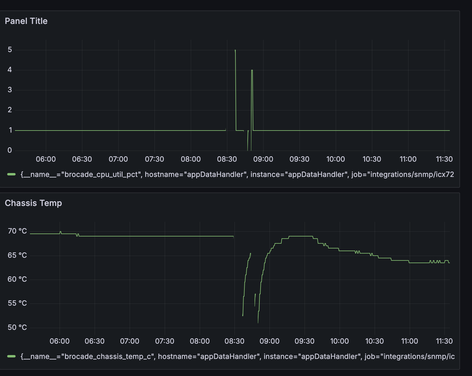

Two more crashes have now occurred since my last graph (one at 6pm and one at 9am the next day). Interesting they seem to keep coming roughly the same time in the morning, but not exclusively given the 6pm one.
It is starting to look like the reboots occur at round number times eg. 9.05 AM, 6.40 pm (rather than 6.42 pm or 9.03 am for example). Which maybe points to something with a pattern/scheduled event rather than just random failures? But I guess we don’t have enough data to confirm that.
Another interesting clue is that there are actually two reboots in rapid succession for each event. Not sure what this tells us though.

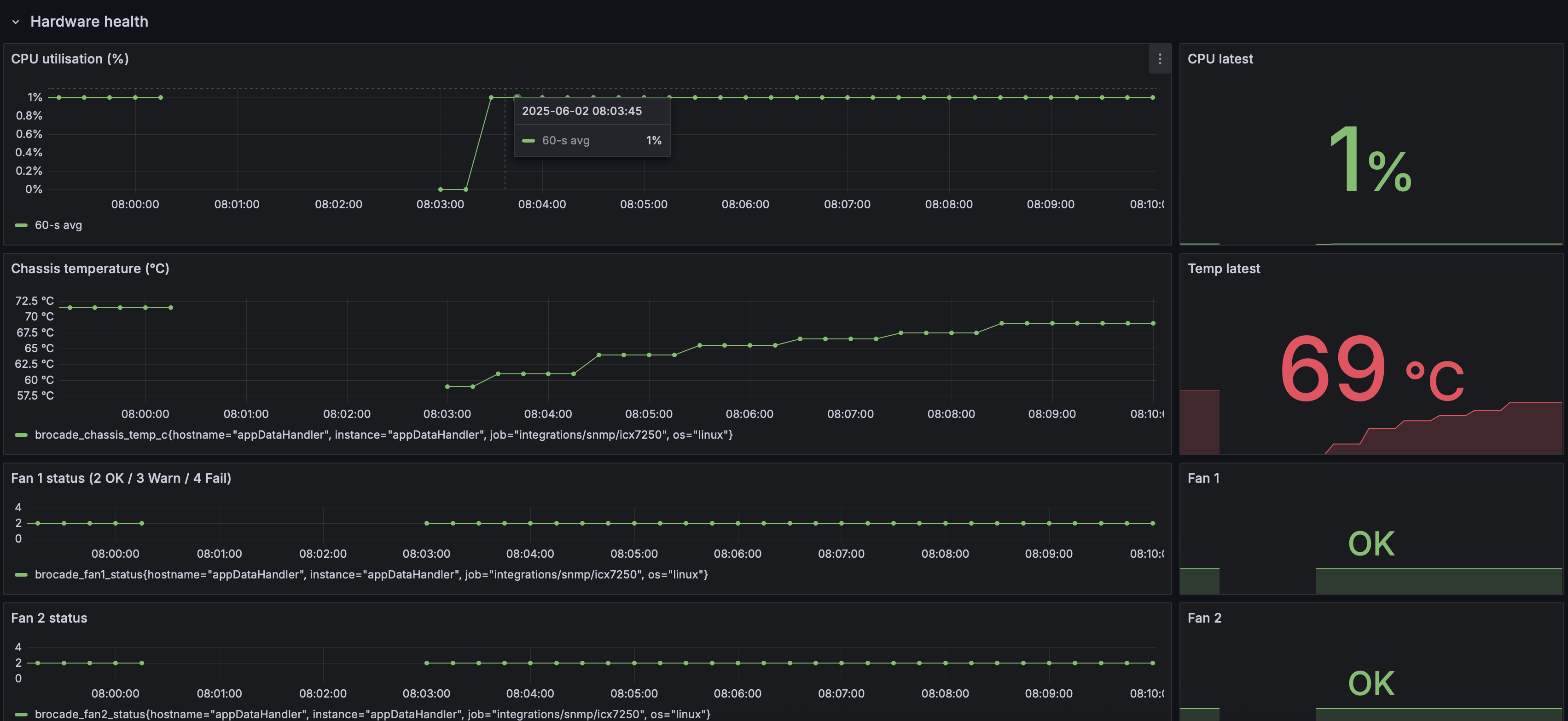

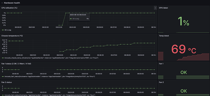

As for the data export, I am currently improving my logging. Here is a screenshot of the event from my latest dashboard setup. Unfortunately, the data being logged drops out for all metrics at the same timestamp so I can’t tell which event might precede the other:

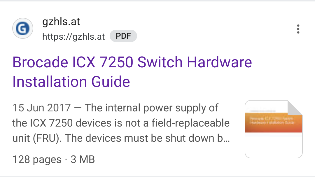

I have identified that the power supply LED on the front is amber and according to the manual indicates failure:
Power LED is Amber: Internal power supply has failed. Contact Technical Support.
So I guess the remaining question is, does anyone know if I can replace/fix the power supply or is it time to buy a new switch?
From a cursory Google search:
Link to PDF: https://gzhls.at/blob/ldb/a/b/e/7/6633931b0f02f6c5019f7d4e6b199bc36d38.pdf
