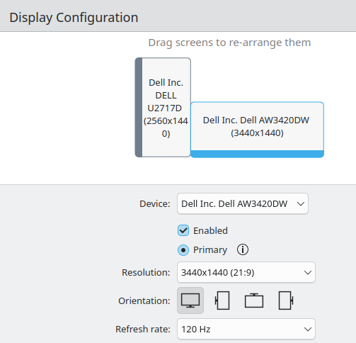

When I turn off and later turn on the second monitor, both monitors remain black, until reboot. I can still move the cursor, and iirc the cursor may change when e.g. hovering over the places where the input fields are supposed to be.
It’s the same when turning on via the settings or via this script:
xrandr --output DP-0 --off --output DP-1 --off --output HDMI-0 --mode 2560x1440 --pos 0x0 --rotate left --output DP-2 --primary --mode 3440x1440 --pos 1440x1120 --rotate normal --rate 120 --output DP-3 --off --output HDMI-1 --off --output DP-4 --off --output DP-5 --off
2024-12-15_10-14
