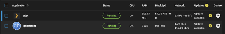

Also, I installed two apps in the app server on TrueNAS, and as usual, they won’t update to the latest version for who knows what reason even though I am not using them. They’re there for testing only:
This has happened in the past with TrueNAS containers; although, it didn’t happen with TrueCharts containers (until they stopped supporting them). Seems like, for whatever reason, TrueNAS containers will get in an “unupgradable” state, and this will always happen no matter what you do.

I assume you hit the Update button? The Update is not automated, you need to actively do the update.
That being said, I do get a bug with this occasionally, but I’m fairly sure that is only visual, as in I update, the container shuts down and comes back up and then it’ll still say update available, which just goes away at some point. No idea why and it only happens with specific containers.

Yes, I click update, but then it fails. And this happens often with TrueNAS containers for whatever reason. But it never goes away for me. Stays there forever. These two have said they needed updates for weeks now no matter how many times I’ve clicked it.

You say it fails, but does it actually give you an error? When it fails then it tells you it failed and why it failed. If it goes through and then just continues to show the “Update available” icon, check the actual version that’s being deployed and compare it against what’s on DockerHub.

I’ll tell you next time it happens. I just removed that App server and moved around things for my existing TrueNAS install, so it can remain the app server.

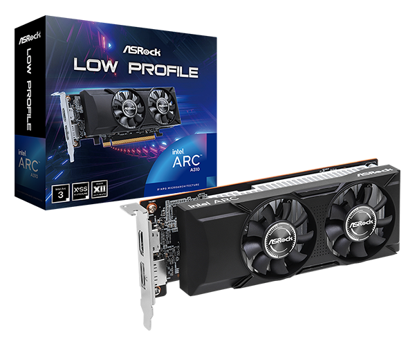

Slightly off-topic, but you might wanna look into an Arc A310:
There’s also an entirely passive card from Matrox (Luma A310), but I don’t think those are available to consumers.

The SPARKLE looks great! 1-slot, and it has multiple video transcoding stream support!
