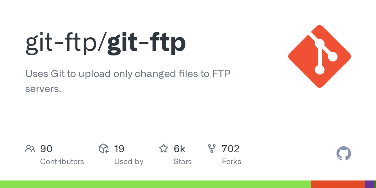

If you're already using git there is a nice extension for git called git-ftp
On debian you should be able to install it easily with sudo apt install git-ftp
This makes pushing changes to a prod server as easy as git ftp push
Read the configuration README.md on the github page to get started :wink:
