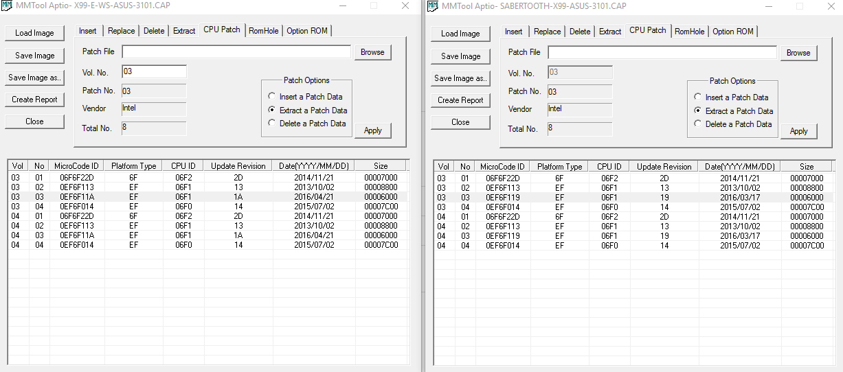

But it isn't isolated to the ES chips, I have looked into it and sabertooth is literally missing the microcode patch for the V4 Xeon lineup.

Boards from other manufacturers that support Xeon V4 have the same microcode patch as the X99WS-E (left)
Asus consumer board has the microcode patch that is on the right, no bueno Xeon V4.
Good news bad news. Good news is that I have an ES that works, but its the final/release version. Bad news its that the other ES CPUs we have are not going to be supported on Asus boards. "Sometimes Intel changes the microcode so that the newest microcode locks out the older ES steppings..." so, not probably not on purpose, but we're SOL on these boards with ES cpus.
We did try retail Xeon CPUs and they were fine.
