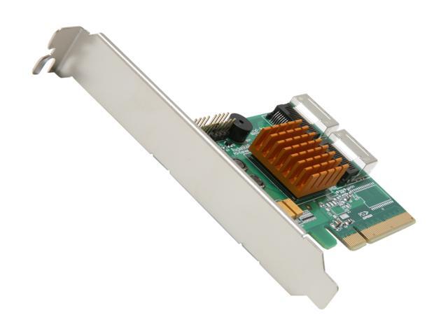

Hm, I do notice that this is a software Raid card. While that's not a huge issue, are there hardware raid cards in the sub 200 dollar range or is that not a thing? Just curious
I actually didn't realize it's a software raid card. Well, doh. The price. Anything below 3xxx series from Highpoint is software raid. At least here in Europe the 3620 starts at something like 400€.

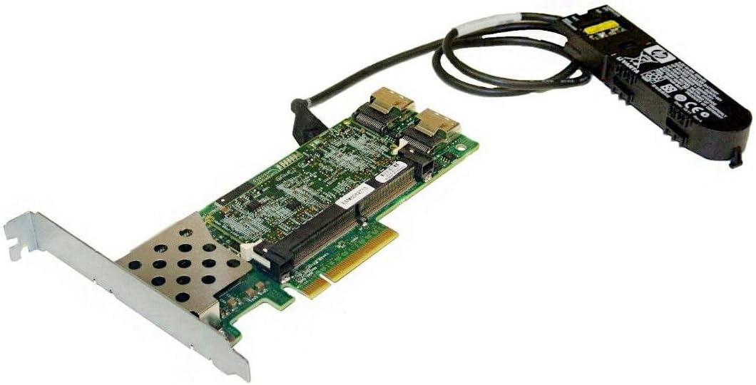

Then there's the HP stuff, Smart Array cards. I don't know much about them. @wendell ? 50 bucks with battery backup? U wot m8, this exact model is 170-500€ in Germany. Here in Finland it's closer to 900€.
Is that a hardware card? PM8011 came up. But who knows what nonsensical license packs you need with the HP stuff. No clue honestly so you might wanna do research. And verify that whatever you buy actually supports over 2TB drives, though this thing looks like it supports them.

Hm, I read that in a review that all the computation for the parity in a RAID 5 setup on that card was done by the cpu, not anecessarily on board controller. Maybe the review was wrong? I'm not sure. I (obviously) don't know much about RAID cards.
Oh, I could definitely get by with a software RAID card. I am using the server for multiple simultaneous 1080p plex streams too, so I have a 4690 for my cpu. I was just wondering if there was a better/more optimal solution and trying to learn about RAID cards in the process.
A host based RAID controller doesn't have it's own CPU for parity calculations so it relies on the CPU of the host system. But the RAID array configuration is stored on the card.
a software RAID doesn't have a RAID controller at all. It just uses a bunch of connected disks and the RAID array is all stored in software on the drives themselves.
If you were to setup a host-based RAID controller and setup RAID0, no calculations would be done on the CPU as there isn't any Parity to calculate.
With RAID5 it just means the CPU on the system will be used to calculate the parity. if the CPU or the Motherboard were to fail, you could pull the RAID card, and all the drives, and move them to a new system and it will preserve the configurations.
With Software RAID.... Windows not only calculates the RAID configuration, but also parity in the case of RAID5(6)
