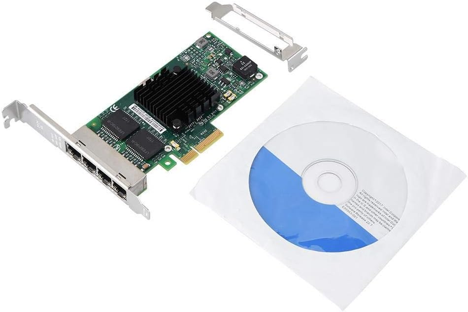

Im looking at getting a NIC for my Pfsense Router.
however not sure what works with PFsence along with the best value.
below are some i have found.
can anyone recommend any better

Intel Pro/1000 PT dual or quad port nic.
This is the most common choice, and i does get the job done for cheap.
I would recommend ebay, you can find them for 20£ some time.
do you know if it comes with a full sized PCI plate?
I’m using an early Intel D33682 dual port NIC with Untangle, couldn’t be happier with its performance.
Thanks for your help
a new one usealy come with both, a refurbish one, well you have to check the description of the product.
I have a few in production for a few years now.
Work like a charm
