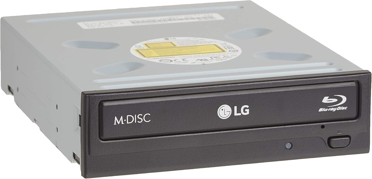

Here’s a great ODD that can handle all the kinds of disks. IT’s $60 right now.
Any cheap external diskette should be able to read+write any dual layer disks, and these disks themselves are quite cheap. But in case you needed to know about the different kinds of disks out there, now you know. So if you have about ~7TiB of data, the option with the least amount of disks would be the quad-layer.
You might be able to find these cheaper else where, but what you need is the ODD and the BDXL disks.
As for software to use these things, I don’t recommend windows as it will cost you. K3B which is available to any linux distro will do the job.
Now about the cost, using the BDXL disks might as expensive as buying multiple long-term cold storage drives right now, however, in the long run it will be cheaper because you won’t have to keep buying drives and testing them every four years or so. You can pretty much just write it once and it will last. That said you should still make additional copies for redundancy. And you should try compressing your data into .xz tarballs as these have the highest compression possible (slowest), and will still be a standard 50 years from now.
Wow thank you so much for all this research! Those xl discs are crazy expensive! I dont think i can justify those xl discs because of cost. I need to get a better job lol. I do have a LG WH16NS40 already! which is good haha…but I can get an 8tb for $230 which is throwing me off. Price is the main driving point.
