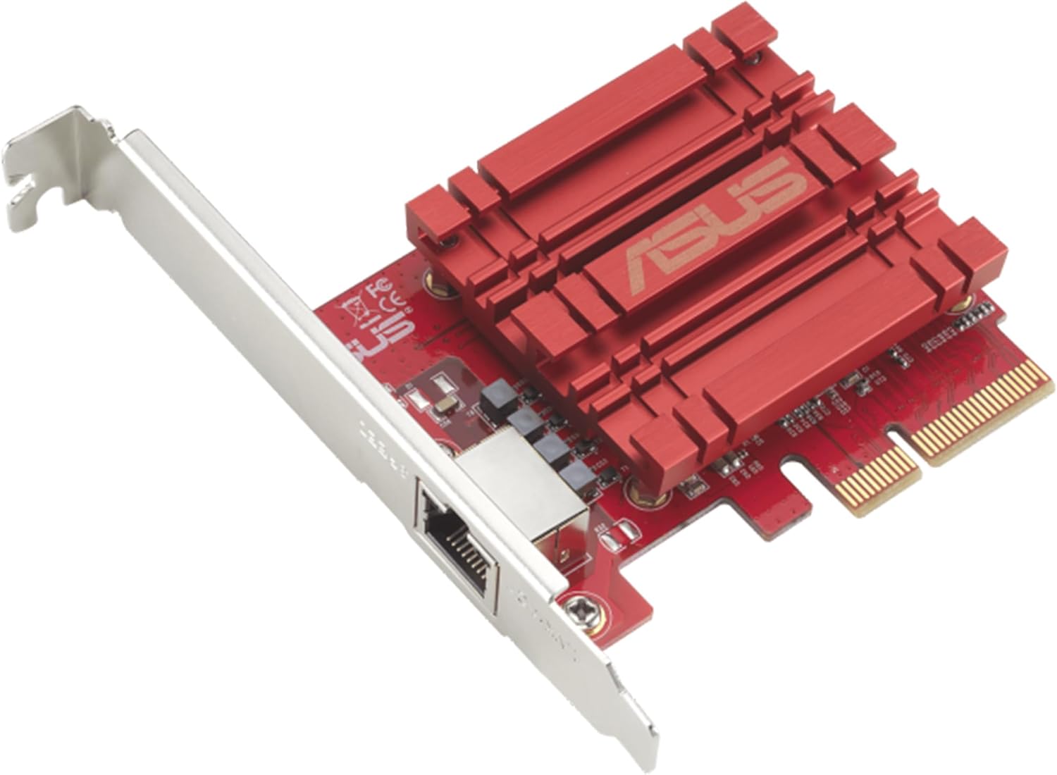

I know you already have SFP+, but I wanted to point out that 10GBASE-T exists.
This is the cheapest, most accessible, way a consumer can get 10Gb speeds. The reviews on the NIC are pretty good, but the switch seems iffy.
These use RJ-45, so no changes to a cable are necessary as long as they support 10Gb over the distance required. Cat 6 cables support 10GBASE-T over 55 Meters for example. Cat 5 does not. Cat 6e does for 100 Meters.
I agree that for a lot of consumers, this may be the solution, but personally I found that a direct host-to-host SFP+ connection was the cheapest/easiest for me, with a pair of those cards second hand being like £35 on ebay, and the cable being around £15. It definitely costs less than that switch or that single NIC. Obviously if you want new from a site like Amazon then maybe 10GBASE-T is the best solution.
