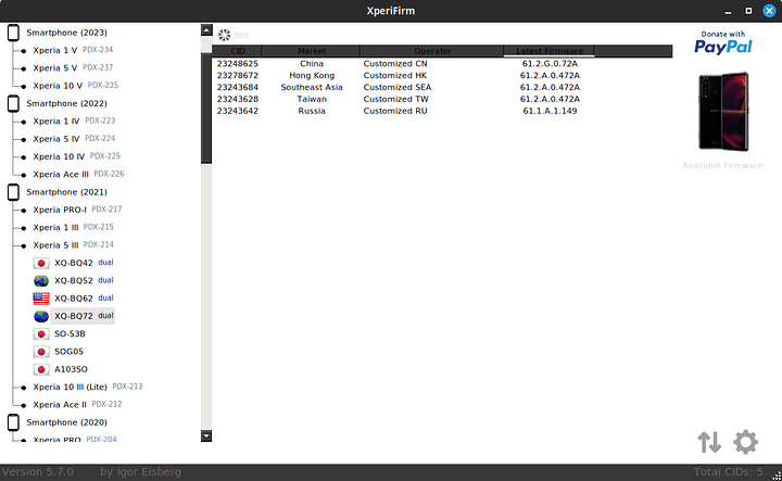

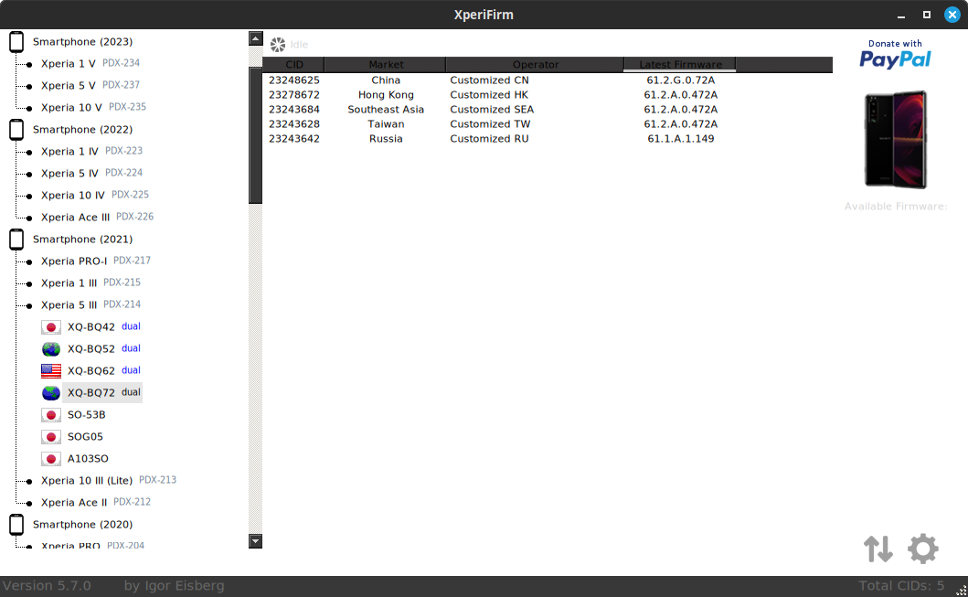

After installing it on Fedora, I needed to figure out which region my phone is so that I have the right firmware. The CDA seems to be a unique identifier and corresponds with a given region
xperifirm has instructions to access the service menu by dialing *#*#7378423#*#*.
When I did that, I did not find a CDA, however I found the following:
Global-C2 - user
However, this did not match up with the info online
I decided to search this to see if there was any others who had a mapping.
This post suggests looking at the certificate within the settings
https://old.reddit.com/r/SonyXperia/comments/16yxgcx/just_bought_1v_what_is_the_global_c2_region/kcj6yd4/
Matching it with the table on xpericheck and using process of elimination with the reply, I determined I have the CDA of 23243628 and a custom taiwan version Customized TW
CDA Name Latest Version Avg Update Time Discovered
23278672 Customized HK 61.2.A.0.472A 37 days 1 year 2 months ago
23243628 Customized TW 61.2.A.0.472A 38 days 1 year 2 months ago
23243684 Customized SEA 61.2.A.0.472A 37 days 1 year 2 months ago
23248625 Customized CN 61.2.G.0.72A 46 days 1 year 3 months ago
23243642 Customized RU 61.1.A.1.149 12 days 2 years 11 months ago
