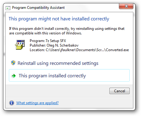

The first thing that comes to mind when you might want to do this is for macros, where some things will allow an .exe but not a .bat. Perhaps something with scheduled tasks, though I think you can use bat files natively but maybe there might be something to an AD forest where exe makes sense. You could also possibly pack it into an msi for use via group policy installation to quickly push out (or update) a particular thing on all your computers in the forest in one go. I’m sure theres some niche for it but never needed it myself.

I haven’t checked these tools, but these are almost always just an EXE unpacker that ends up running the batch files at a later state.
