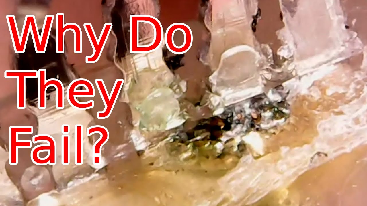

I saw this this video on bad Molex to SATA adapters and I'm curious if anyone is using them. I have at least one currently in service which I plan on replacing as soon as possible.
The guy who did this video actually had his file server catch fire because of these connectors. The type of adapter that is prone to catching fire is the moulded type whereas the insert type seem to be more robust because of the separation between the wires.
