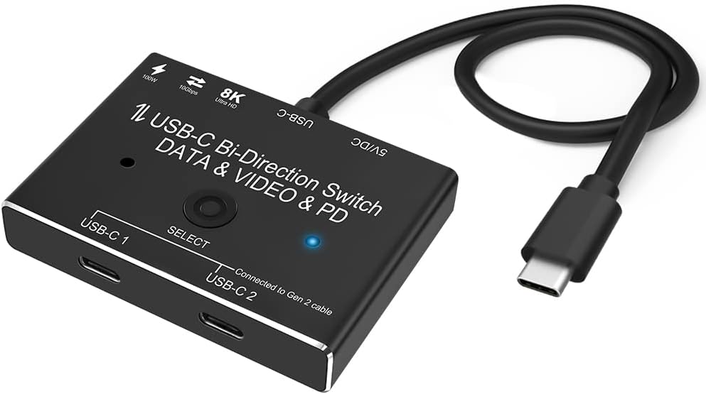

This might be overkill, but I got this type c display and usb switch recently
Using my monitor’s built in usb, I can switch between my desktop and my laptop passing through my keyboard, audio interface, mic, and speakers when I push the button. With USB C connection, the switch, and my monitor’s built in usb ports I effectively have a kvm
Though it sounds like you already have a plan with the picos. If you do go for the raspberry pi solution, you could use pikvm as your software
Nah, I don’t need to switch display stuff at all, the monitors just Auto-Switch. They also don’t have USB-C in. And the Pis (and they are just microcontrollers, not full Pis) also would just detect whether a device is active.
