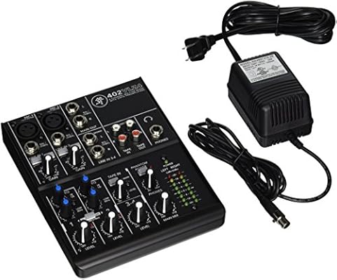

I would recommend this mixer instead.
The Dac looks nice! I don't see a mango, did you mean the Magni? You don't need an amp if you plan on just plugging your headphones into the mixer.

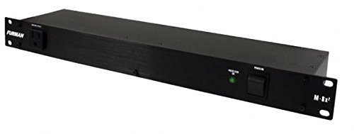

Btw, to REALLY isolate the electrical noise of your computer from the mixer / mic, use a power conditioner for just the audio gear. (don't plug your pc into the conditioner, that would defeat the purpose)
