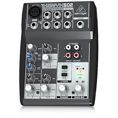

I would also consider getting an external device, such as a simple USB mixing board.
something like this would do nicely.
Because it's USB, it can act like a line in, and it removes your on-board jacks/sound card from the mix.
