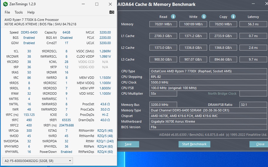

I’ve done countless exploration into “anomoilies” possible regression…
I have run many straps…6000/2000 6400/2133 6600/2200 8000/2000 8400/2100 8800/2200.
Even explored 2233 albeit with slight latency penalties…
2 things remains constant when compared to 7700x…I can’t max out the theoretical copy cap 70250 ( 2200 fclk ) and 71250 ( 2233 fclk )
Karhu output in mb/s is down…bestr so far is 258mb/s compared to 273mb/s.
Any thoughts and i can provide a multitude of screenshots buts lets start with the unicorn as that one definitely makes you say hmmmmm.

Secondly I am an internal tester so while I appreciate your feedback i’m well aware and have 9950x and 9950x3d sitting here but this is just about anomalies where a single ccd is not matching a previous gen single ccd.
expected behavior at 2200 fclk is 70250 higher write speeds and 70250 copy.
expected behavior is being able to get about rougly 270 mb/s in karhu on a good sample 7700x/7800x3d.
9700x is not exhibiting expected behavior. Not even A unicorn synced 8800/2200.
Like i said i have tested all optimal straps so while i appreciate your concern of 1/2 even 6600/2200 is not better. nor is 6800/2233 or 7000/2233.

7700x

I tested on phase change at -35c If you look closer at the bench mate program you will see I’m already wattage uncapped :wink:
The reason we tested at -35c was to free up the imc more to see if we could ever get the write/copy up…and still could not even at 8800/2200 synced. You can tell i’m synced as the latency boost is significant. Sync is working as expected however…copy/writes are still not expected.
