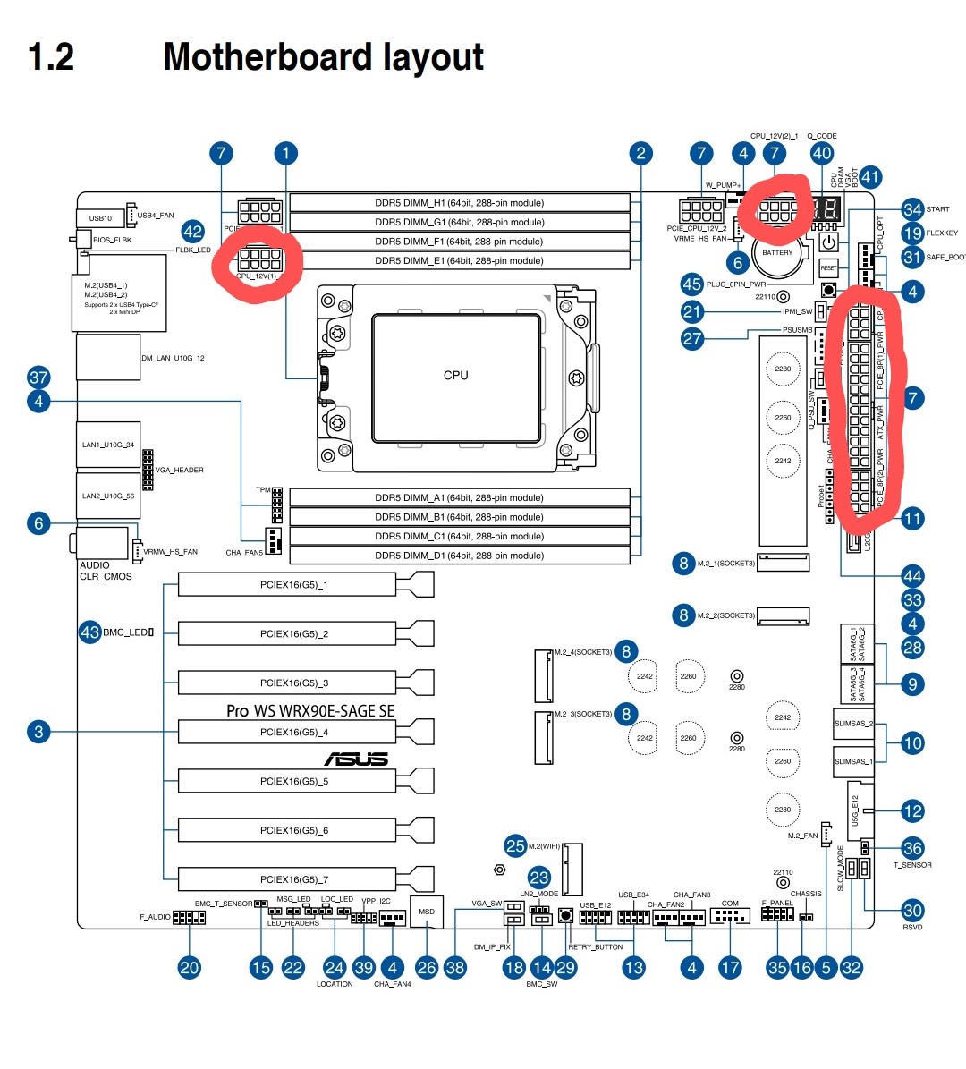

I have an extremely similar setup (same: mobo, CPU, PSU; different RAM, AIO cooler). Your description matches the same config that worked fine for me, including the PSU jumper to single rail and the locations of the PSU cables to CPU_12V(1)_1 and CPU_12V(2)_1. I agree that your system should work based on what you describe, but I want to avoid making assumptions about the unmentioned items:

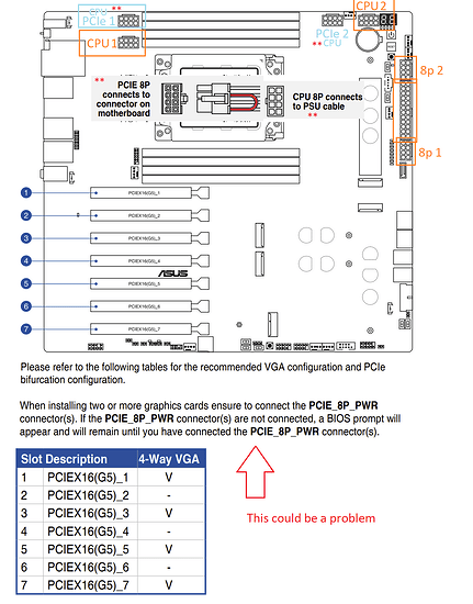

If you have multiple GPUs, the mobo may need more power (PCIE_CPU_12V_1 and PCIE_CPU_12V_2). In my similar build, I needed to use the cross-over cables that came with the mobo. Attached below is a page from the manual + annotations with more info.

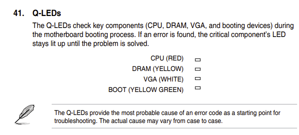

@Nick83 Check for colored status lights near the Q-LED:

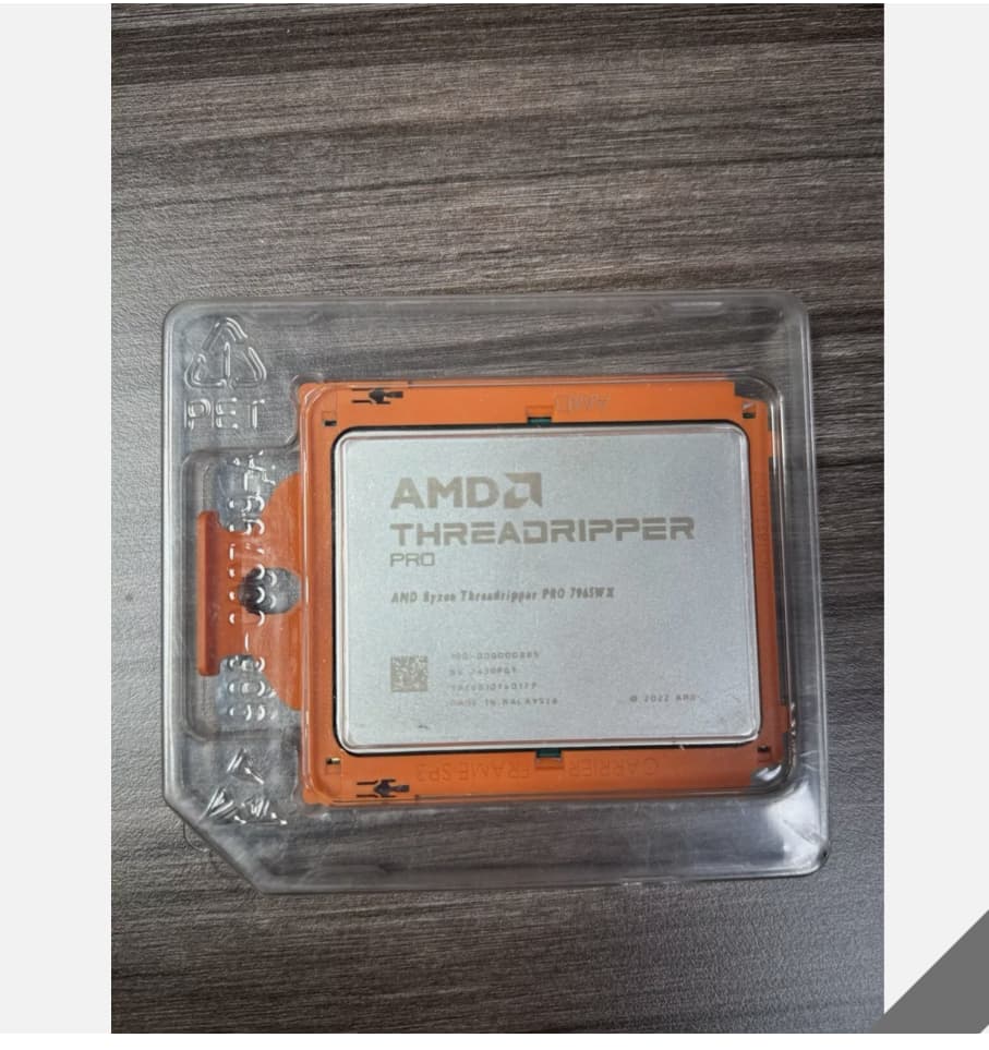

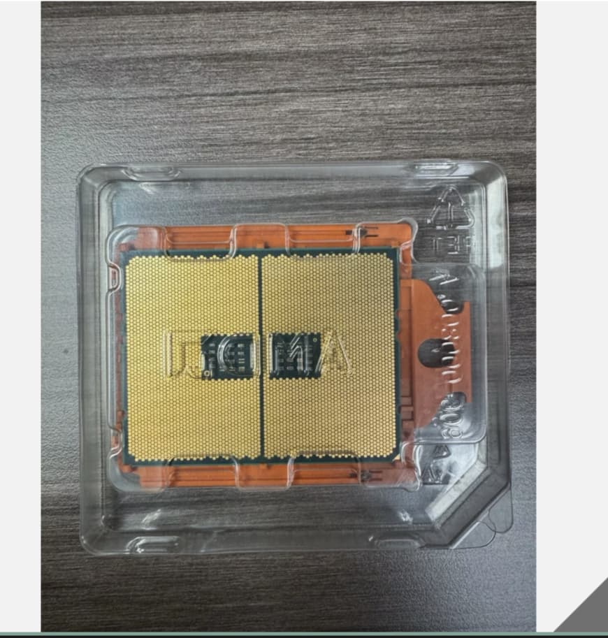

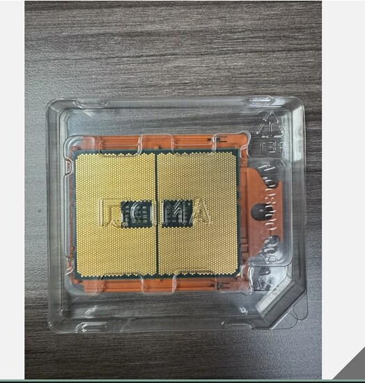

Thank you so much. Looking into the cpu a bit more I realized I got scammed. The cpu I bought is a 59xx or 39xx model with a 7975 heat spreader. Really messed up situation.
It actually bent the pins on the socket a little but it should be ok still. Getting a new CPU.
WTF… That’s outrageous
Yeah WTF. In case you are curious. Here is the listing.
79xx series has a single area of transistors this is something older.
Edit: ebay link didn’t work added listing pics instead
That’s outrageous, and I’m sorry you got scammed. Though it certainly would explain your computer not booting at all.
