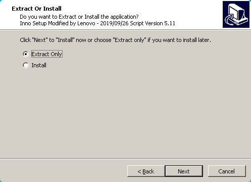

  2. Unpack it (DO NOT INSTALL – this may flash your nic and brick it like mine :woozy_face: )
    20240809_13h28m33s_grim
  3. Unpacking will prompt you for a folder (default is C:\DRIVERS\...)
  4. Go to this folder with the terminal and execute EEPUPDATEW64e.exe \nic=1 \dump (assuming you have a single intel nic – the one that comes with the board).
