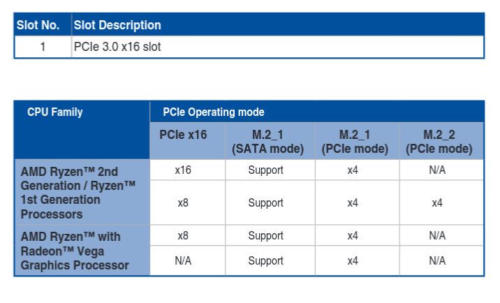

The table in the manual seems to suggest that only the first slot (top of mobo) supports mSata.
Screenshot from 2024-08-23 16-01-36
So, to use both drives your PCIe slot will drop to 8 lanes electrically (8x).
My bad, it is a common mistake people make so I assumed you also made it without looking deeper.
As @jode showed, it seems like you can only run the back m.2 as a PCIe device, and then only with x8 support on the GPU. For the front m.2 slot, yes, this supports mSata always.

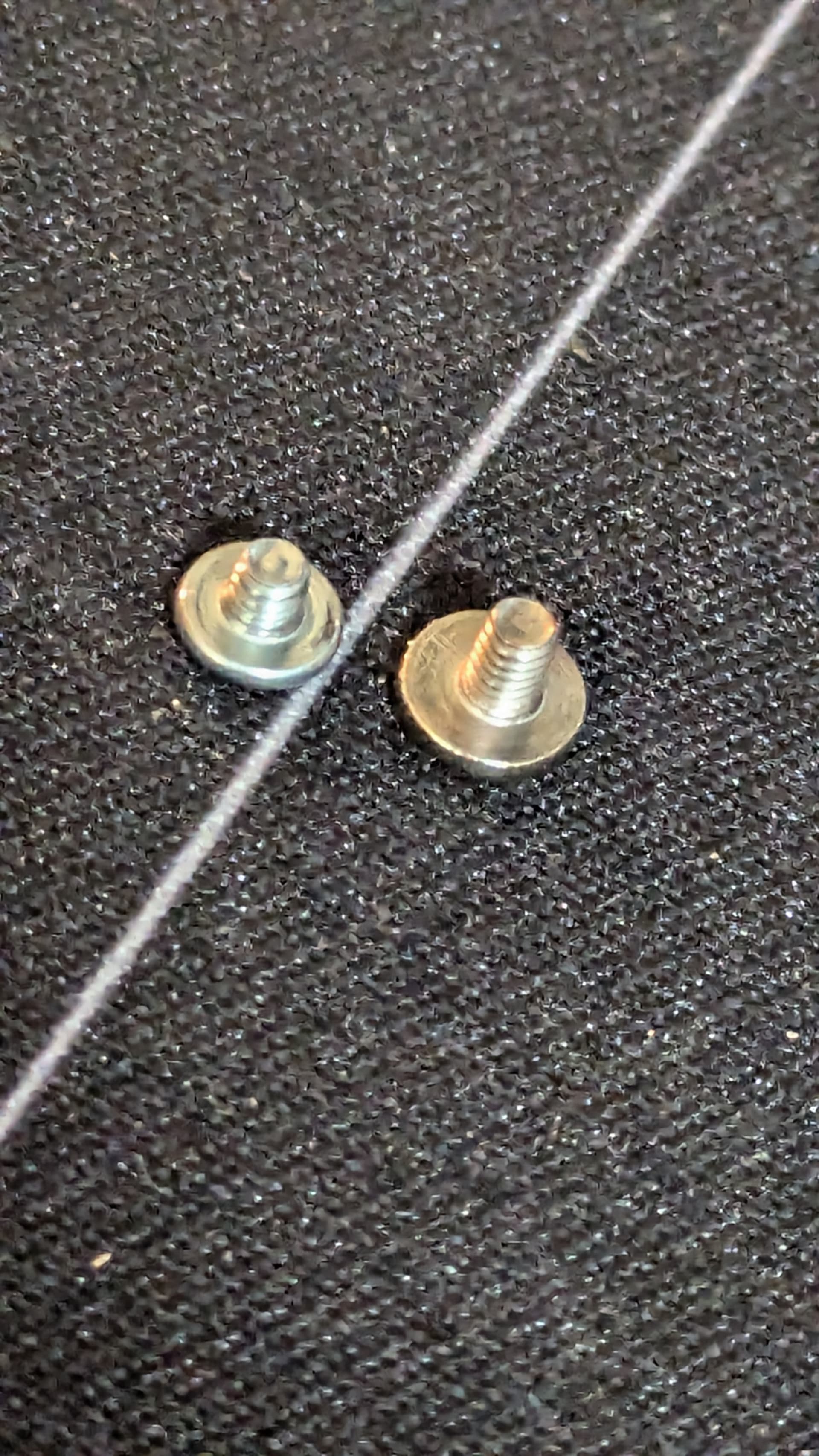

Side question: does anyone know the size and where I can get a replacement small screw that mounts the SSD in slot 1 under the cover? I’ve lost the original mounting hardware and purchased a kit on Amazon with 2 different size stand offs and screws. I used these on the back but they don’t work for the front. The threads on the OEM screw that’s stripped are shorter
Well, Amazon has a few kits, otherwise MicroCenter should have you covered.
Can you replace the mobo standoff with a new one you got from Amazon? Careful - don’t strip the threads in the mobo!
This is likely what I’ll do provided the threads on stand off are the same length. I’m not sure the sizing of the original screw as the kit I bought claims to have m2x2.5 and m2x3mm and they’re too long.
