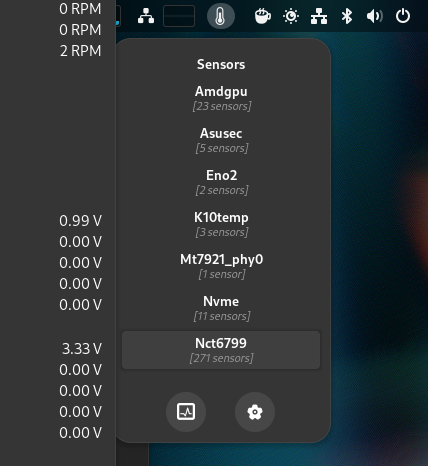

Finally was able to update the kernel to 6.5-rc2 and have my Nvidia drivers.
Also now I can load both the nct6775 and asus-ec-sensors modules natively without address kludges and have my correct SIO chip nct6799D show up and finally report all my active fan channels.
So between the two modules and k10temp, I have my full suite of sensors on my Asus X670E Crosshair Hero board and have the correct overview of my running state under BOINC loads.

The asus-ec-sensors module is still a work in progress. I was getting a race condition with concurrent access by somebody. Working with the developer we managed to use a global mutex lock that stopped the massive spamming of the race condition in the logs. He still needs to figure out what the correct name for the mutex lock on the ACPI tree is. Will eventually push the fix upstream to the HWMON maintainer.
