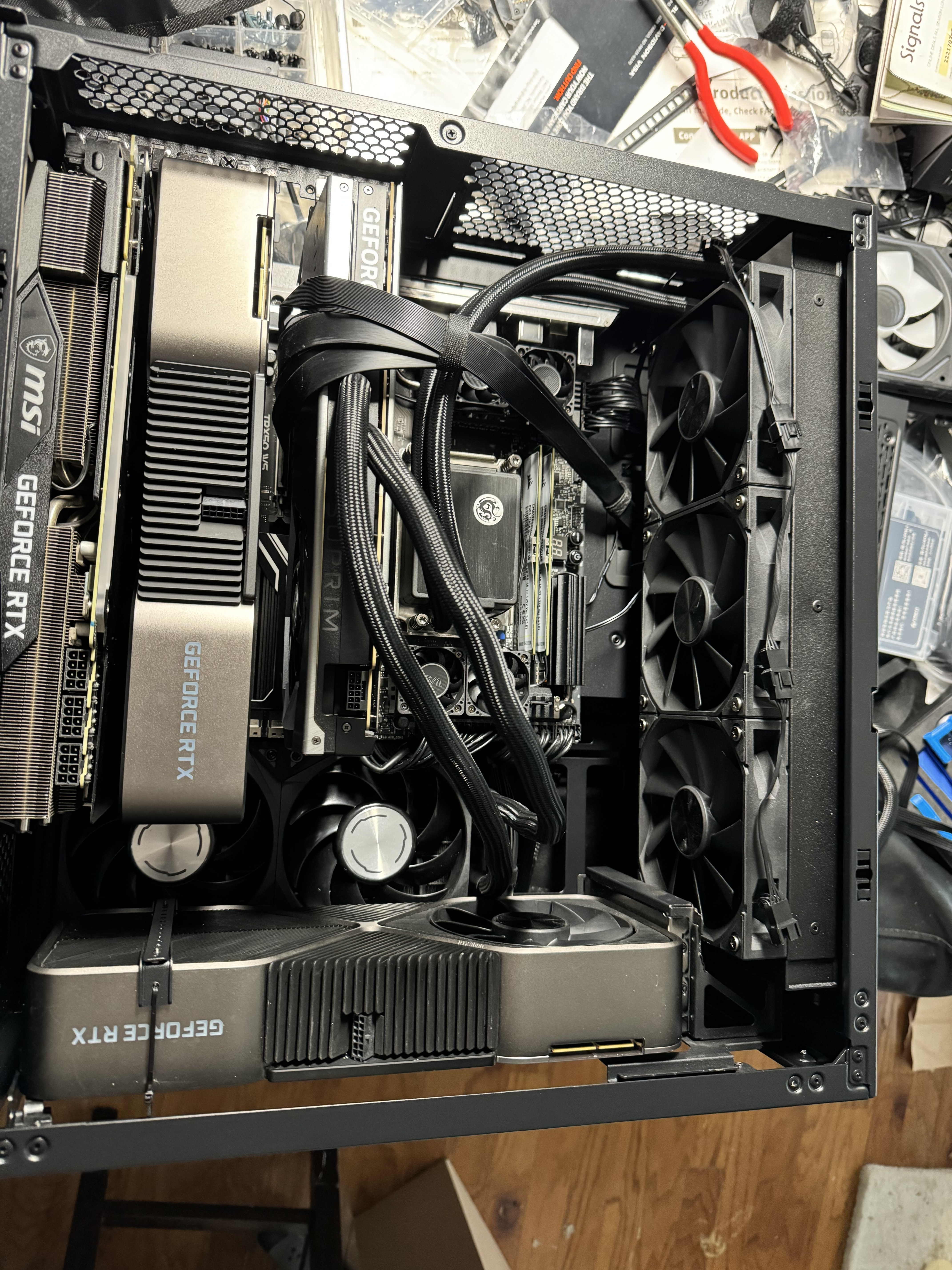

Here is my issue. I installed Windows 11 Pro and it works fine for the most part. Ubuntu 24.04 won’t even boot after clean install.
I am getting pretty poor performance running LLMs to begin with and experienced the first crash while we running Failspy Meta Llama 3 70B Instruct q6 which take about 55gb of vram. I ran it again as well as other models with no issues other than it seemed to not want to run that well. You can see a Reddit post about it here.

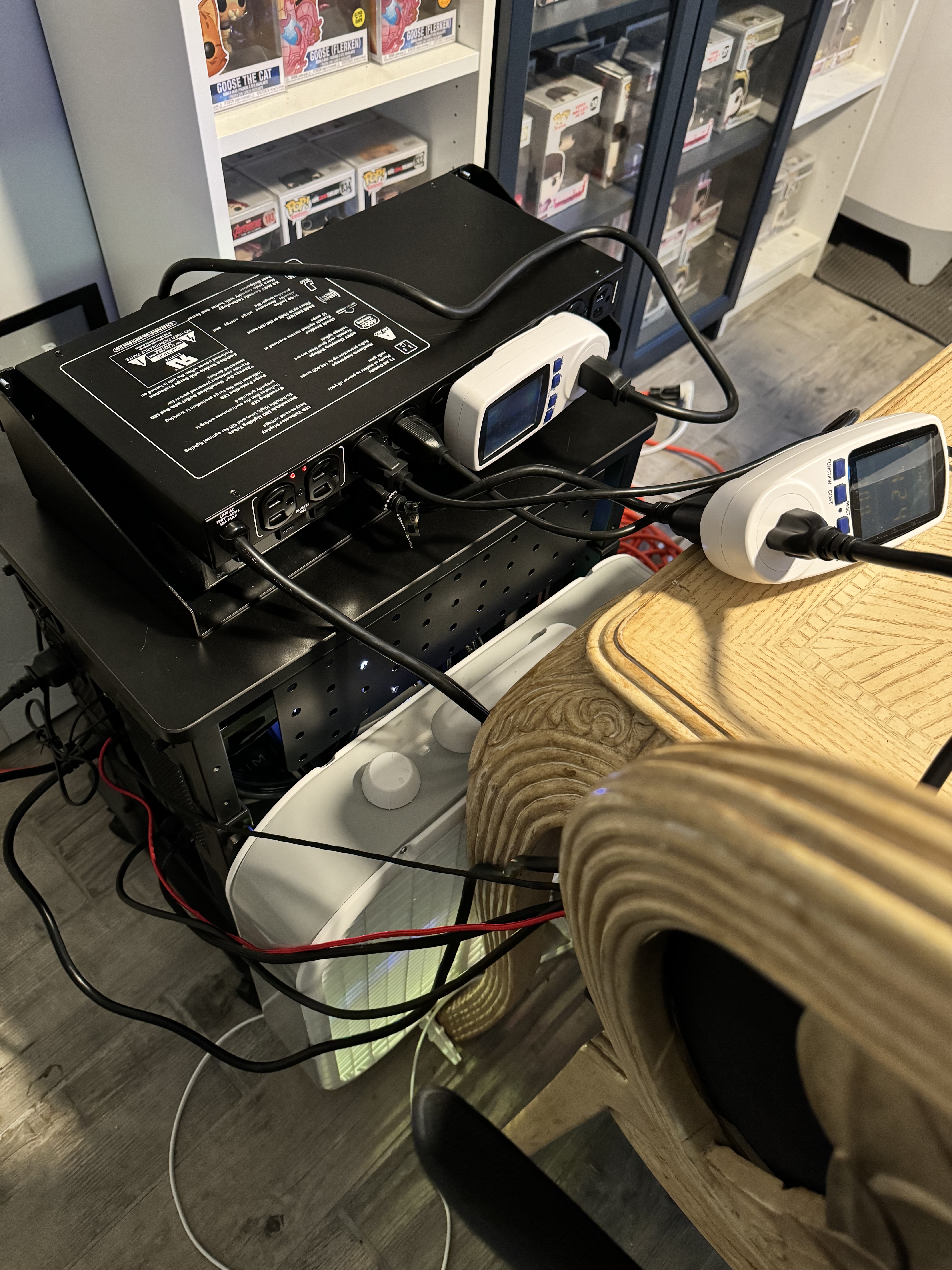

However, out of curiosity, I decided to try running Cinebench. I can reproduce what happens 100% of the time. I start the GPU benchmark, it starts warming up and as soon as it begins the test the machine shuts off with Kernel Power error code 41.
Am I pulling too much power for the board? It only has that 6 pin connector. This would be very unfortunate as I have spent a lot of money to build the machine.
On a side note, temps are great. I haven’t seen anything exceed 40c as yet. Yes, I am using a box fan to cool it.
I did have this issue (similar anyway) with a refurbished 3090 that had a bad memory issue but I have run all of these cards through their paces in different machines, so I am not inclined to think this is the issue.
Could mixing the 4090 with the 3090s maybe be an issue?
Also, the 4090 is running at 16x, 2 of the 3090s are running at 8x and one at 4x (on a Lian Li 900mm PCIE4 riser cable. Could this cause a similar issue?
So far, I have not seen the machine use over 700w total even while running Deepseek Coder V2 Lite Instruct f32 and using over 60gb vram.

I have the same TRX50 motherboard with 3 GPUs running it and a 2050W power supply. I’m amazed that a) your temps are 40c b) you only using 700W. With 4 GPUs you should be seeing a lot more. I can hit over 1600W on my 7970X with 4090, 2x 3090s.
Are you sure it’s on? :grin: . I highly doubt it’s the motherboard. If the PC shuts down as it fires up a power hungry task I doubt you are supplying enough power to meet the demand. What PSU are you using? Are you using a dual PSU setup? System shut downs like you describe can be the power protection on the PSU tripping.
I imagine you have plugged in all the power connectors on the MB? it has a lot!

Thanks brother. I am reviewing all of the suggestions you have given. In the meantime, I removed all but the one 4090 and am still experiencing the problem.
I think I may have narrowed the problem down to PSU cables. It seems Thermaltake uses a proprietary cable setup as the PCIE plugs are different and they didn’t include enough for my setup. I had some Asus cables that worked but as soon as I turned on the machine, it fried the PSU. Hopefully, there was no damage to anything else. :neutral_face:
I once fried a PSU when a metal key fell off my desk and hit it while my computer was on. I wasn’t as lucky as you might be; the fried PSU destroyed a two-year-old computer. Here’s hoping you have better luck than I do.
Ok, I finally got this stable last night by undervolting the GPUs to between .9mv and 1.015v meaning they are limited to 1.015v under load. I ran cinebench and scored 74,000 multiple runs in a row so I think it’s good enough. I also rearranged some cards and ended up with 2 4090s and 1 3090 but I am able to load Bartowski Deepseek Coder V2 Lite Instruct f32 (I will actually use a q8 guff) with 96k context by using 18 GPU laters and all 48 cpu threads for 15.6 tok/sec which is acceptable. The q8 fully on vram with 124k context is over 30 tok/sec so I am happy :smiley:
