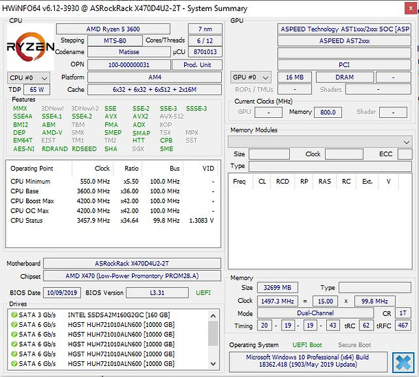

For this I’ve overclocked the memory from 1333Mhz to 1500Mhz, keeping all other timings the same. At 1533Mhz or 1567Mhz the mobo no longer posts and requires a clear CMOS to recover.
These are my default settings (bottom right are is the memory)
And these my overclocked settings
However, with the overclocked settings I’m failing to log any memory error at all on both Windows and Linux…
Both memtester, memtest86+ and Prime95 Blend can run for hours without error at this speed.
I suspect that ECC actually does work and corrects many errors, but it doesn’t report anything to any OS? (because just slightly increasing the frequency causes it to not post at all anymore).
