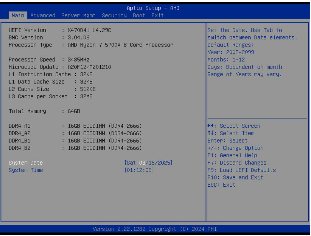

I recently installed two more 16GB UDIMMs on the board.
The X470D4U (probably all X470 boards) will run two UDIMMs at 3200MT without overlocking, and 2666MT with four of them. That is fine.
We see all four ECCDIMMs in the BIOS:
All good? Oh, but wait, Linux has a slightly different opinion:

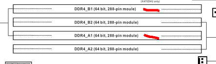

Sticks are in A1 and B1
So I am not sure if 4 sticks is relevant or not. Did you get different output before you added more sticks?
