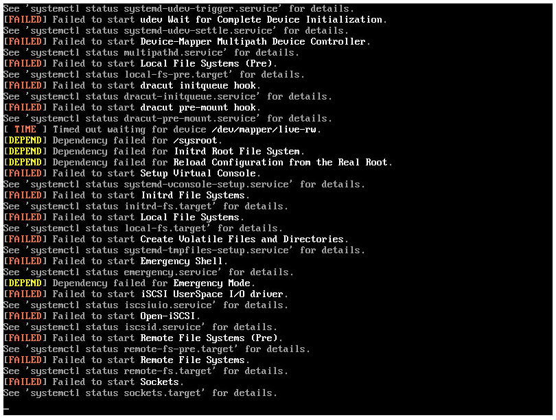

@wendell , has Fedora 30 included a hotfix for systems with Zen 2, outdated AGESA and broken RDRAND?
@nx2l
You can boot a Fedora 30 Live system where you get to a nice desktop after a short while and during the boor sequence there are only nice green “OK” lines? (That’s the way it is working on my X570 Taichi with AGESA 1003 ABBA, on the X460D4U with AGESA 1003 x? I only get to the error messages (cp. screenshots some posts above)

verdict is…not good
Yeeeees, that’s more like it (broken RDRAND).
That 50 min startup job is a consequence of that, compare:
At least we are all on the same page and I don’t expect my X470D4U to have a hardware defect.
The void remains.

The drive i used to boot from was a fresh install of f30 which i setup initially on the 3700x and a B450 motherboard.
I have tried 3 different boot devices:
  • USB 2.0 thumb drive
  • USB 3.0 thumb drive
  • SATA SSD
All three lead to the same behavior on the X470D4U/3700X (BIOS 3.20) and boot just fine on an ASRock X570 Taichi (BIOS 2.00 with 1003 ABB or 2.10 with 1003 ABBA).
So I’m about 99.9999 % sure that it is as his wendellness has stated in the linked thread that the AGESA is outdated meaning RDRAND is still broken leading to various OSes not working properly.
Again the only way we got is waiting for ASRock Rack to release a new BIOS, maybe if we’re not naughty we’ll get it for Christmas?
