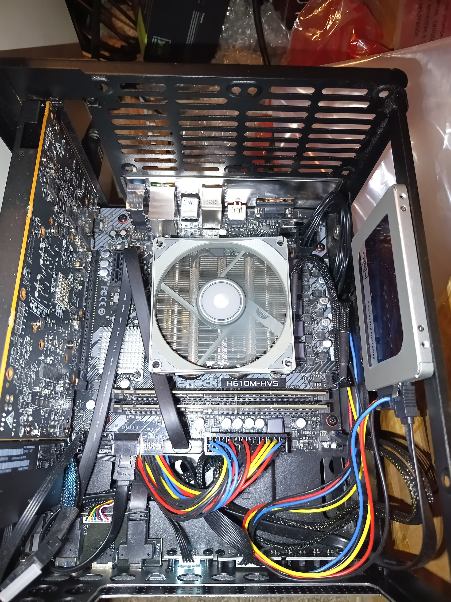

Here’s what a mini-DTX motherboard looks like in it. I’m going to put an HBA card in that x1 PCIe slot as soon as I get one.
I knew that, but the other side uses SATA connectors. Is the physical connector the same but the protocol different? I’ve never use SAS in my life, so I’m just curios. The minisforum is a standard mini-itx size, now I just need to wait for the card to arrive and order the drives.
