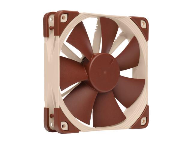

What 120mm fans could you recommend me? I heard about Noctuas but can´t afford them, and I need 2 more fans for the front, but my motherboard (which is a cheap one I bought to replace my broken old one) doesnt have too many CPU headers...
EDIT: The case temperature is 38ºC
https://pcpartpicker.com/product/b2vRsY/noctua-case-fan-nff12pwm
18$ on newegg with free shipping and handling. most 120mm fans will be around 10-20$ USD unless they are on clearance. also you need static pressure fans to pull the air into the fans through your case's "aesthetic" peice of metal blocking the intake, then push the air through the drive cage.

You can never go wrong with Noctua. If you wish the best - Noctua fans, Seasonic PSU and HGST hard drives...
If you want to go cheaper, atleast on the fans front, check out one of the listed above...
