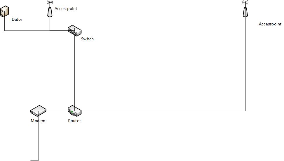

So I am to set up a new network for my house and workshop. The easiest way for me is to show you how I think it should be:
The right part is my workshop which is about 20x20m and about 8m to the
roof. As you can see I want to have one ap in my house and one in the
workshop. At the moment I just got an ADSL connection, but I might
install fiber soon and all the cables are cat6. I’ve been thinking about
getting the Ubiquiti Unifi AP-AC Lite or the Unifi AP-AC Long Range (Not sure about the difference here)
but I’m not sure about the performance of it and if it’s worth the
price. Also, are these omni directional APs any good to have in a house
with alot of walls and such?
The router in the basement is an Netgear R7000 running DD-WRT.
But basicly what I want is an good and stable ap with both 5 &2.4ghz (that is both ac and n) with good range.

Howewer I wonder what the main differences are between the Ubiquiti Lite, Long Range, Pro models?
The lite and long range are 2x2 so they have a speed of around 800mbps whereas the pro is 3x3 and has around 1200mbps. The lite and long range are pretty much the same except the long range has more range.
