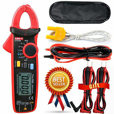

Not long ago I went looking for a clamp meter that would be able to make non-contact measurements of DC current (nearly all clamp meters just do AC current). Cheapest one I found was a: UNI-T UT210D. Direct from China, several listings on eBay for $37USD right now.
I think it would be a pretty safe unit to start off with. The most common way to blow up a multimeter, and possibly hurt yourself, is having it configured for (probe-based) current measurement (“10ADC unfused”) when you shouldn’t. This unit doesn’t have that setting, only non-contact current measurement, so there’s no risk of that. Plus the NCV option in it (and most other new clamp meters) can prevent you having accidents with live AC voltages you weren’t expecting.

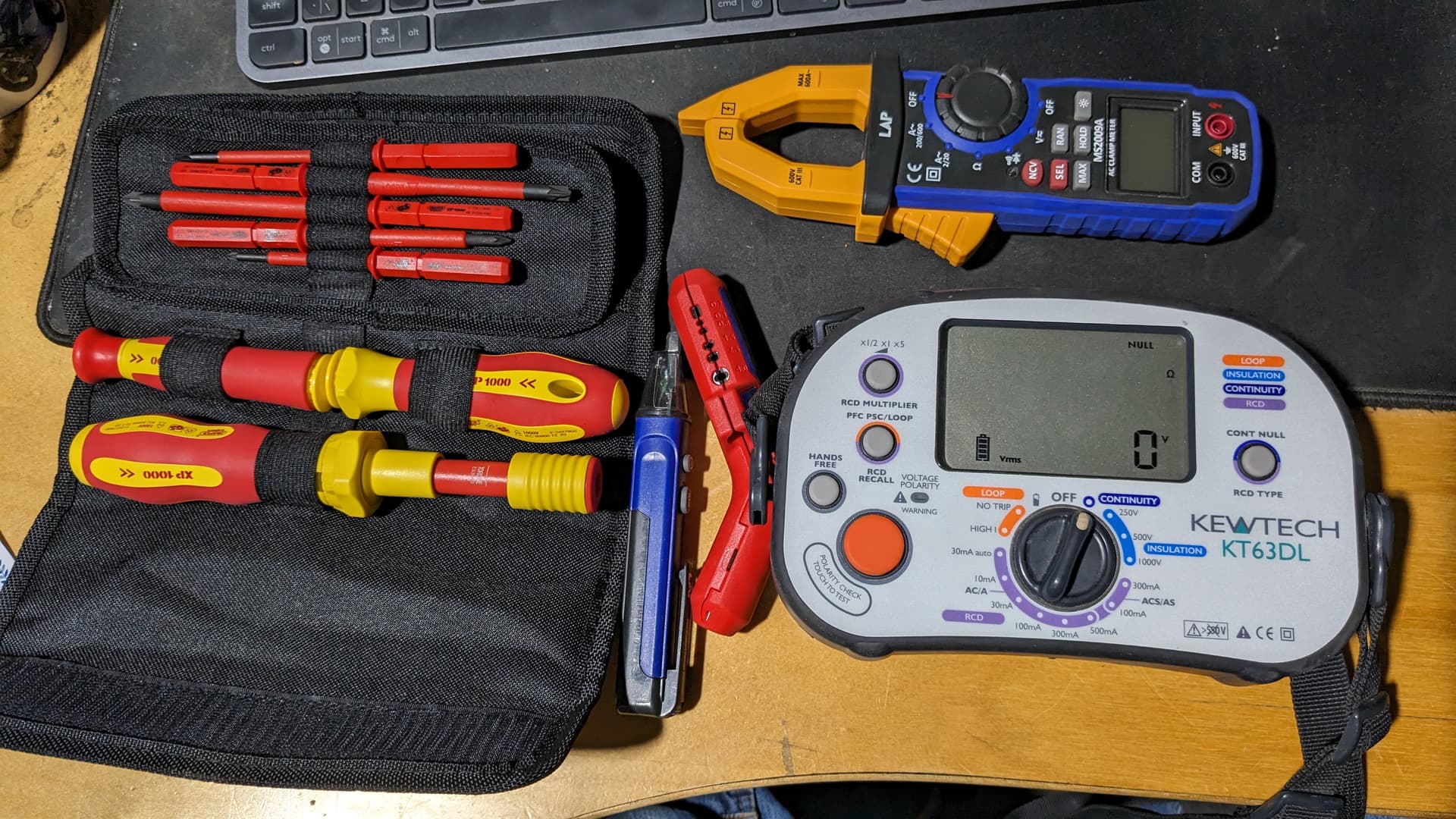

Since I’ve been doing electrical work, I’ve gotten a few other tools (these along with insulated screwdrivers and other bits and pieces)
I think so long as you get tools that protect you firstly, followed by protecting the device itself, you’ll be all good. :slight_smile:

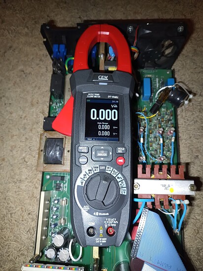

I just got a new clamp meter and so far this brand seems decent. I kind of wish it had USB-C charging like all the bleeding edge meters have, but at least it does datalogging which seems to becoming a more common feature.
I think we’re in a renaissance of good meters coming out with more features than we use to have at ever lower prices so I’d recommend on holding off as long as possible for getting a good meter, and avoiding “old” SKUs of multimeters when you do get one.
