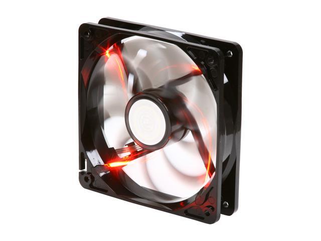

This one
and this one
I see the CFM is better on the cheaper fan. I am not sure about Static pressure but I think I saw on another site the cheaper fan boasted a higher SP as well.
