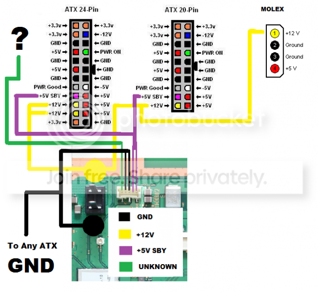

I'm going to do basically the same thing. The signal voltage for the power reset buttons should be 5V which should be fine for most Arduinos. I also believe that you can much more easily program the Arduino to display a web page as it's only a few lines of code for a simple page and there are already some shields that are designed for that. You could also configure the Arduino to connect to wifi.
To power the Arduino I would tap the standby power. Tap the purple wire and any black one. I would personally pick up a 24 pin extension cable and tap that, not my PSU. Once you're wired into the PSU you should be able to power up the PC by pulling the power pin HIGH with the Arduino. Same with the reset pin.
